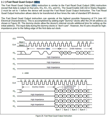

It is mentioned in the errata sheet of STM32L4R5 in Section "2.8.1 CSBOUND must not be used" section that CSBOUND feature does not work properly and must not be used. The CSBOUND[4:0] bitfield of the OCTOSPI_DCR3 register must be left at its reset default value (0b00000).

w25q64jv revj 03272018 plus.pdf p31
The register values after calling octospi_open and octospi_memory_mapped will be as listed in the first QA.
