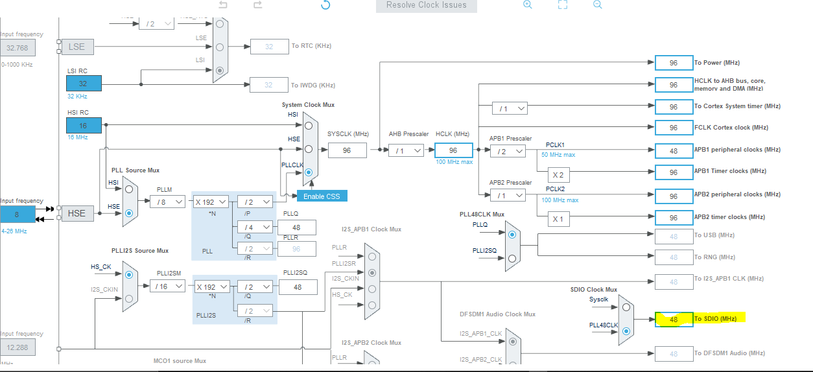

Just adding some additional MCU configuration settings:

I'm using the SDIO peripheral in 4 bit wide mode but I found that initialising as 1 bit wide works and reverting back to 4-bit works:
https://community.st.com/t5/stm32cubemx-mcus/sdcard-does-not-work-with-4bits-wide-bus/td-p/602607
