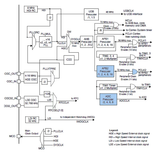

Hi, i have implemented the example TIM_OCToggle from stm32f40xx to stm32f103xx, both work fine.
I want a event in the moment change state output pin of the channels OC, as occurs in the events:
HAL_TIM_PeriodElapsedCallback   or   HAL_TIM_PWM_PulseFinishedCallback

Resolved:
For mode Compare Output is absolutely necessary the value for Period(for HAL library) equal to 65535(filled registry of 32 bits)
View the schematic:

waclawek.jan
Posted on March 26, 2018 at 18:43
You probably want to enable the CC interrupt(s), but I don't use Cube/HAL so don't know what's the proper way to do it - maybe using HAL_TIM_OC_Start_IT()?
Posted on March 26, 2018 at 19:20
Yes, this function
HAL_TIM_OC_Start_IT() i
s called on final of I
nitConfigTIM2_OC()
Posted on March 26, 2018 at 20:48
And without using the HAL, as it should be?
Posted on March 27, 2018 at 01:56
You are using HAL,
you can look inside that function and see what they have done.
I would go to the callback, and add some lines in the User section.
Posted on March 27, 2018 at 10:16
Well it's just setting the interrupt bits in TIMx_DIER; but if you say it's been called (and you can verify it by reading out and checking the TIMx_DIER in debugger) then the problem is elsewhere.
