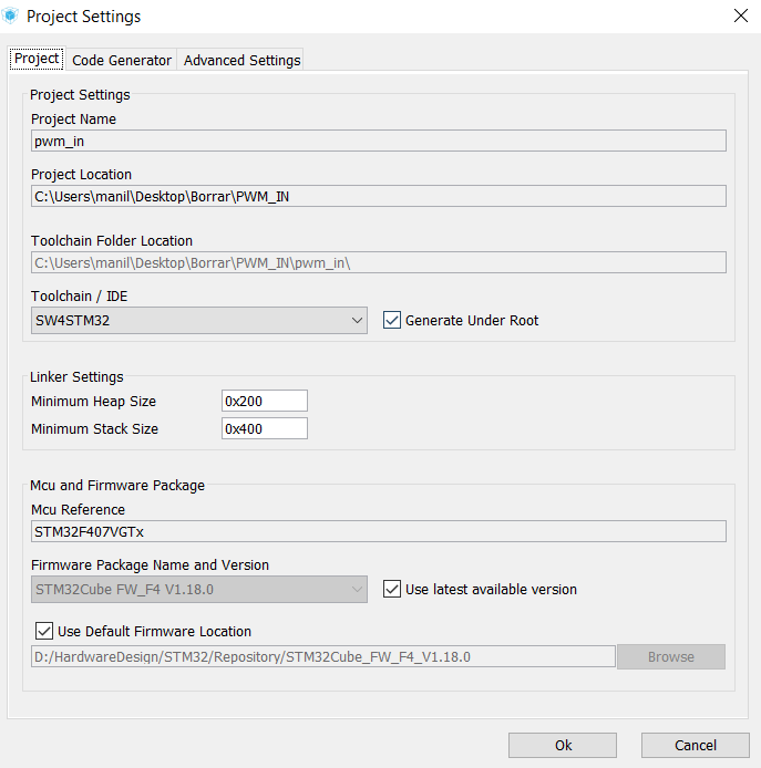

I've been working with eclipse-workbench for half a year now, creating my projects from STM32Cube tab inside eclipse and exporting them to eclipse. Until now everything was working fine, I could edit the .ioc file and update the configuration to eclipse without any problem.

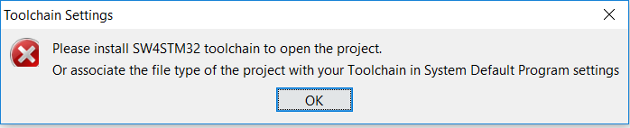

Don't know why, but since today, when I try to create a new project or edit the ones already were working, I have the following error:
''Please install SW4STM32 toolchain to open the project.
Or associate the file type of the project with you Toolchain in System Default Program Settings''
Any clue how to solve it?

I installed latest version of CUBE with no succeed. I've installed  â€œSystem Workbench for STM32â€� again, keeping the previous installation (now I have 2 Workbenchs) and both are working now, so I'm going to keep it.

Posted on May 25, 2018 at 11:56
Hi
maniljo
Do you face the issue with the latest version of CUBEMX (4.1)?
-Nesrine-
Posted on May 25, 2018 at 12:17
Hi
ELMHIRI.Syrine
Thanks for you answer. Right now I'm not in front of my computer, but pretty sure is above 4.
I've been using Workbench/CUBEMX oftenly for almost a year and it worked perfectly.
Quite extrange problem since it is reproduced on the projects that previously worked fine.
Posted on May 25, 2018 at 12:56
Hi
maniljo
Please try to use the latest version and tel us if the issue still again.
-Nesrine-
Posted on May 27, 2018 at 15:40
