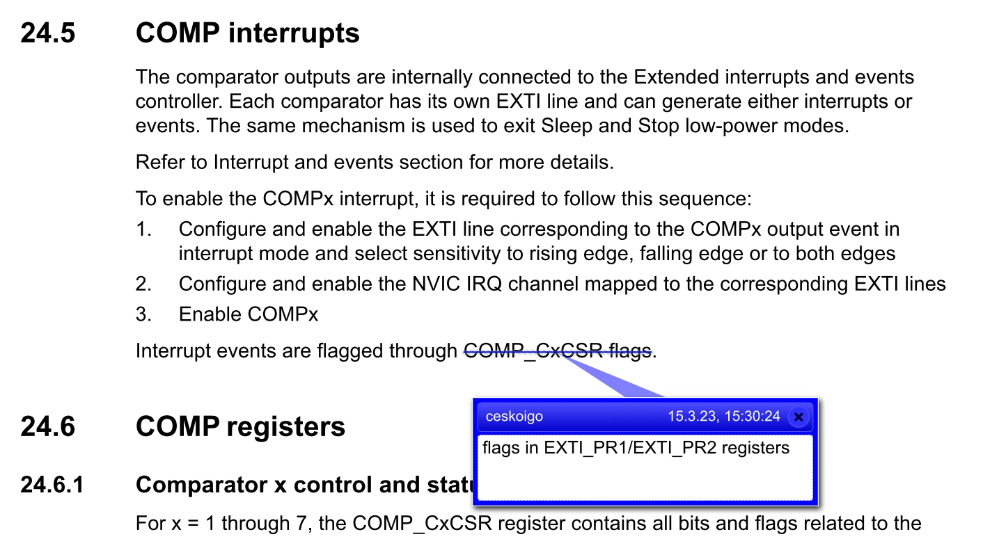

I think there is an error in the reference manual (RM0440 Rev 7) in chapter 24.5 - COMP interrupts.
At the end of this chapter it says: "Interrupt events are flagged through COMP_CxCSR flags."
But in COMP_CxCSR register there is no flag for interrupt event?
The Interrupt is handled by EXTI, so the Flags are in the EXTI_PR1/EXTI_PR2 register.
Or do I miss something?

I confirm the error. An internal ticket (ID 147682) is submitted to correct the sentence which should be:
0693W00000aJ3AkQAK.png(PS: ID 147682 is an internal tracking number and is not accessible or usable by customers).

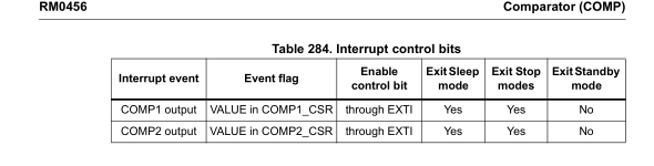

This is probably one of those not-that-well-thought-through half-truth we see ocassionally in the RMs, maybe in response to some customer's complaint. I went through almost all other STM32 RMs and never seen this particular line. Most of them at the end of COMP interrupts subchapter contain a table - a not very useful either - such as this for 'U5:
0693W00000aItd8QAC.pngWhat the "...flagged through..." in 'G4 RM is supposed to mean is, IMO, the "Event flag" column.
@Imen DAHMEN​ , can this sentence in 'G4 RM please be removed or at least rephrased to be less confusing? Or, maybe it would be the best to bring it in line with other STM32 RMs, adding this table (and then also consider adding it to 'F3xx RMs, too).
