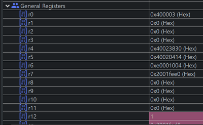

Example code where READ_ENABLE=1:
08002aa8: ldr r2, [r6, #0] start = DWT->CYCCNT;
08002aaa: str r0, [r4, #0] RCC->AHB1ENR |= RCC_AHB1ENR_GPIOBEN;
08002aac: ldr r1, [r4, #0] [r1] = RCC->AHB1ENR
08002aae: str.w r12, [r5] GPIOB->ODR = 1;
08002ab2: ldr r3, [r6, #0] end = DWT->CYCCNT;
08002ab4: ldr r1, [r5, #0] result = GPIOB->ODR;
 Registers at start of that code:
96 MHz clock, prefetch enabled, data cache enabled, instruction cache enabled.
[00.002678] Clock description:
[00.002839] - System clock selection: PLLCLK using HSE @ assumed 8 MHz
[00.002994] - PLL scalers: M=/4, N=x192, P=/4, Q=/8
[00.003133] - Prescalers: AHB=/1, APB1=/2, APB2=/1
[00.003324] - Clocks: VCO=384 MHz (in range), SYSCLK=96 MHz, HCLK=96 MHz
[00.003508] - Clocks: PCLK1=48 MHz (timers 96 MHz), PCLK2=96 MHz
[00.003612] - Clocks: 48MHz=48 MHz

[00.004723] - Clocks: PCLK1=21 MHz (timers 42 MHz), PCLK2=42 MHz (timers 84 MHz)
[00.004874] - Clocks: 48MHz=48 MHz
[00.005195]
[00.005235]
[00.005328] Results for GPIOB->ODR:
[00.009487] ticks=6, result=0, FAILED <-----
[00.013657] ticks=9, DSB=1, result=1, pass
[00.017846] ticks=7, READ_ENABLE=1, result=1, pass
[00.022039] ticks=7, READ_PERIPH=1, result=1, pass
[00.026234] ticks=6, NOP=1, result=0, FAILED <-----
[00.030408] ticks=8, NOP=2, result=1, pass
