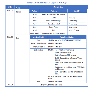

Hi team,
  We have our own customized USBPD board (STM32L562CET6) which support both SPR(100W) and EPR(140W). SPR is working great, now we want to work on 140W using EPR mode. So that initially we have tried to enter EPR mode by following method
#define USBPD_EPRMDO_ACTION_ENTER (uint32_t)(0x01 << 24)
#define USBPD_EPRMDO_DATA_ENTER (uint32_t)(0x8C << 16)
eprmdo[0] = 1; //Header - no.of data objects
eprmdo[1] = USBPD_EPRMDO_ACTION_ENTER | USBPD_EPRMDO_DATA_ENTER;//EPRMDO
status = USBPD_PE_Request_DataMessage(0, USBPD_DATAMSG_EPR_MODE, eprmdo);
But it returns "USBPD_FAIL". Please clarify me that "Is it possible to enter EPR mode by using above mentioned method? If yes, please correct me why i am getting USBPD_FAIL status."

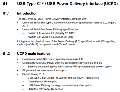

    Hi @AVND
    First, using Extended Power Range, according to spec, you can reach up to 240W,
    Second, EPR-capable Source port is defined in USB Type-C 2.3 standards. However, STM32L562 complies with USB Type-C specification release 2.0 as stated in the reference manual (and in datasheet there is a typo).
    To give better visibility on the answered topics, please click on "Best answer" on the reply which solved your issue or answered your question.Best regards,FBL

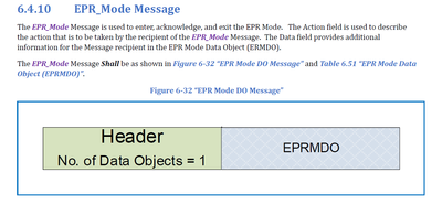

    Hello AVND,
    STMicroelectronics USBPD library for EPR is still under development so you won't be able to build EPR apps with it.
    The flow to negociate an EPR contract is not as simple.
    You need first to negociate an SPR contract and then enter in EPR mode, then the source can present EPR PDO and you will be able to negociate an EPR contract.
    Best Regards,
