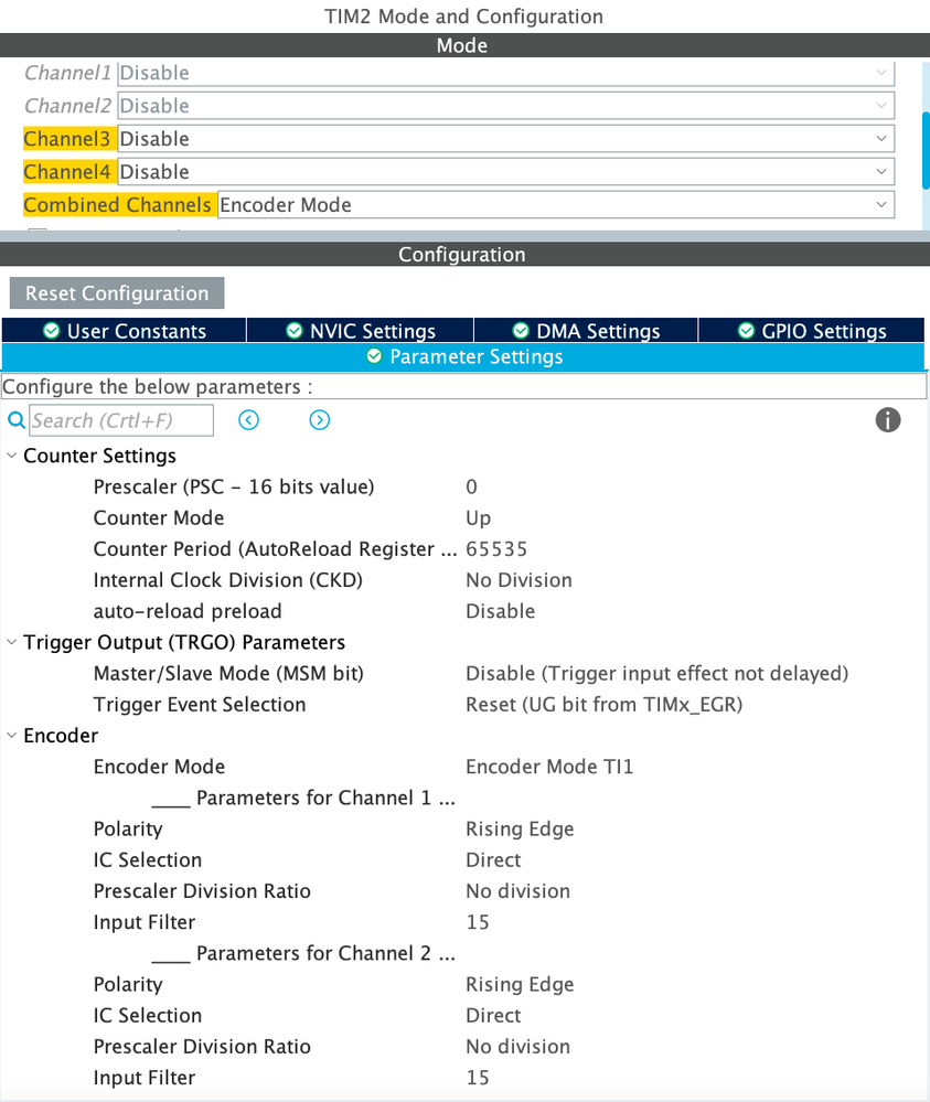

I'm trying to simulate a quadrature encoder signal coming out of an automotive car seat motor. I don't have the motor but I do have the hall sensor used in it (Allegro A1221LLH). The Vout from the sensor is not accessible in the motor and its a 3-pin sensor converted to a 2-pin setup. Hence some hardware processing was needed to make it readable by the STM32F407. The good part is that it works and I see a nice square wave when I rotate a magnet over it (its not strictly quadrature since I have only one sensor for now).
I tried reading the count by configuring TIM2 in encoder mode. However I dont see the count increment. I see either 0 or the maximum ARR value (65535). What am I missing here? I've used the same count function with a standard optical encoder and that works fine. Here is the code:

It seems that encoder is configured to use 2 pins, so you need the two inputs, with signal in quadrature. This allows the counter to identify if value should be increment or decremented.
As you have only one signal changing, the counter is doing +1 then -1 then +1.
Pin sequence should be like : 00 then 01 then 11 then 10 . If you change the direction, it will do 00 10 11 01.

Yes I'm aware of the 32-but counters but how would that matter here? I did not want to paste a wall of standard CubeMX auto-generated code but here is the configuration of the timers, Its configured only for the rising edge of TI1

looks like timer is just count one up then count down,and repeat. You could try change one of the ICPolarity to falling edge.
2021-01-27 1:18 AM
That did not work. Yes instead of counting to 65535 it counts only 0 or 65535.
2021-01-27 7:39 AM
For the encoder mode, do both inputs need to be active? I ask because I only one sensor and hence only one input is active.
2021-01-27 7:53 PM
I see you only have one active signal. you should use External Clock Mode 1. use this signal to clock the timer is appropriate . Another way is to change TIM_ICSELECTION of the inactive input signal to INDIRECT. this may work.
2021-01-28 3:22 AM
I don't see any of these parameters in the configuration menus. For ICSELECTION I only see DIRECT.
2021-02-17 12:44 AM
