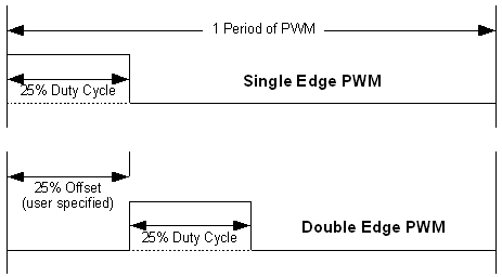

Hi All,
I would like to set my STM32F4 Nucleo to do double edge PWM, but for the life of me I cannot figure out how to do it. More specifically I am trying to do it on three channels of TIM1. To put it visually, I am trying to do something like this:
Thanks for you time.
Dylan

    Thank you for the response. I have had a look at the cook book but it is gibberish to me, I find it very difficult to follow. Perhaps you could refer me to the section that would aid me?
    Thanks,
    Dylan

    You can't do this with a single  channel of some TIMer. Maybe a HRTIM channel can do that. Or you use 2 channels and connect both channels logical.

    Posted on May 17, 2017 at 23:15
    Hi
    Bonnes.Uwe
    Thanks for the response. Yes, my progress today has shown that you are right. For starters, this is not possible with the STM32F4 as it does not incorporate the new timer features of newer micros. The STM32L4 timers do have this features and so I have migrated to one of these. I am still working out how to use it, but at least I know it is there. This is documented in AN4013: STM32 Cross-Series Timers Overview.
    Thanks,
    Dylan

    Posted on May 17, 2017 at 23:25
    Nice catch.
