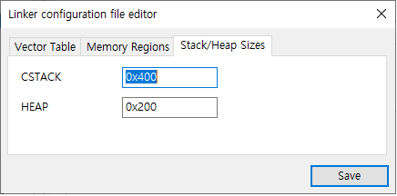

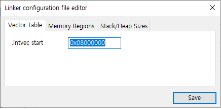

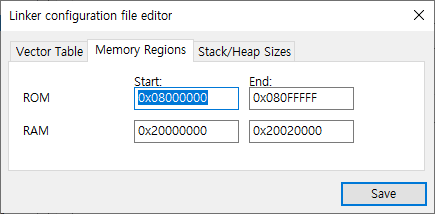

Does not start up power on or h/w reset
sjaey.1
If i use IAR's Download and dubug, the program works normally.
However, if i do H/W reset or Power off/on, it will not operate normally.
what should i check?
MCU : STM32F205ZET
IAR 8.40.2
Own board
ST-LINK V2
Is BOOT0 pulled low?
2 REPLIES 2
sjaey.1
You have incorrectly connected the BOOT0 PIN.
Thanks a lot.
