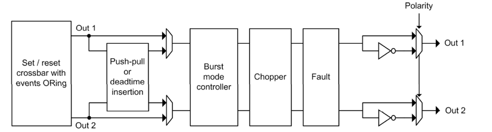

Hi @Pierre_Paris
How sure are you on this?
I discovered this presentation:
https://www.st.com/content/ccc/resource/training/technical/product_training/group0/58/ad/f9/d5/64/2b/49/05/STM32G4-WDG_TIMERS-High_Resolution_Timer_HRTIM/files/STM32G4-WDG_TIMERS-High_Resolution_Timer_HRTIM.pdf/jcr:content/translations/en.STM32G4-WDG_TIMERS-High_Resolution_Timer_HRTIM.pdf
And looking at page 36. There appear to be a dead time insertion on fault.
Or is this related to "Burst mode delayed entry" and the DIDL bits.  If this could be used without actually using the burst mode controller, that might acheive want I want.

  • After a fault is triggered, outputs go into predefined safe states without any deadtime. It's an emergency procedure and we can see in the schema under that fault stage is directly close to the output to go faster. We even care about the impact of the filtering option on faults they can introduces a slight delay on the state outputs.

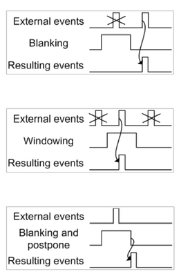

  • Did you consider the blanking or windowing mode ? In fact, we can have a quite similar behavior by conditioning faults signals.
