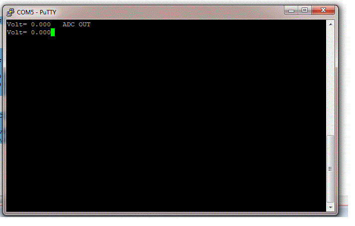

Dear All,
Some thing wrong with DMA operation please advice

Result is zero

    DMA_Configuration() is commented out, but the DMA converted value is used.

    Thanks for the reply Your catch is correct but the result is the same

    Is it necessary the read_adc() function while DMA is available? As per my program. Is following syntax read the ADC1 DR register? DMA_InitStructure.DMA_PeripheralBaseAddr=0X40012440; Please advice
    Not if you us
    e
    ADC1ConvertedDMAValue
    . The base address is correct.
     You need to uncomment the first //DMA_Configuration()
    statement in Main(); Cheers, Hal

    After your advice my program is working now. In additionally I changed the following
    void read_adc(){
    ADC_StartOfConversion(ADC1);
    while (!DMA_GetFlagStatus(DMA1_FLAG_TC1));
    DMA_ClearFlag(DMA1_FLAG_TC1);
    volt=(float)(ADC1ConvertedDMAValue*3.3)/0x0fff;
    sprintf(&Result[0],''
    Volt= %1.3f'' ,volt);
    Print(Result);
    delay();
    As well as, Should I know about Since the DMA uses the same system bus(AHB/APB) , then the system will wait to access other peripherals until DMA release the bus, Finally the total system will be slow/....? As per my above program I cleared DMA flagonly, but I did not clear the ADC flag Any advantage and disadvantage Please advice
    DMA is the fastest method. It is activated by the ADC to transfer the converted value from the ADC DR register to memory. This takes a very short time, then the bus is available for other peripherals. Testing for ADC EOC then reading the DR register will slow down any equal or lower priority peripheral task.
    As per my above program I cleared  DMA flag only, but I did not clear the ADC flag. Any advantage and disadvantage
    The ADC is running continuously. I am not very familiar with the F0, but there is probably no need to clear the flag.
