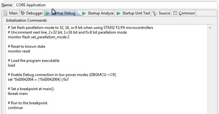

We just bought ST-Link to debug our software. Everything works great with Atollic and Seger J-Link with ST32F407 chip.

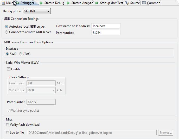

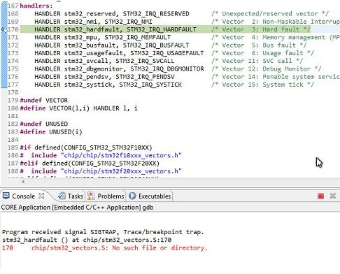

But when we switch to ST-Link, we can flash the chip, but when start the debugger (in JTAG mode), it stops everytime SVC call is made to switch context with Hardware_Fault.
Any ideas?
I have tried copying startup script for J-Link into ST-Link and that doesn't help.

Yes, I do have latest firmware. When I step through using Segger, I see the handler for Hardware fault.
But when I try the same on ST-Link, it says no such file or directory.

'' When I step through using Segger, I see the handler for Hardware fault.
But when I try the same on ST-Link, it says no such file or directory.''
Definitely Atollic getting it's internal nicker in a twist then.
