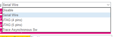

when it comes to programming and debugging, what is the difference between the 4 types (see screenshot below)?
Which one is best and how do you decide which one to use?
Please don't just say they all work the same pick one... :) I am asking for the pros and cons of each and how to choose one with a precise logic.
- Serial Wire
- JTAG 4 pins
- JTAG 5 pins
- Trace Asynchronous Sw
Thank you :)
9 replies
waclawek.jan
July 8, 2024
If you need to ask, you want to go for Serial Wire (SWD), as the 99% of users do, and as is the cheap and out-of-the-box option on boards like Nucleo with software like CubeIDE.
To use JTAG of either form, you'd need some very good reason (e.g. you already have JTAG equipment you want to use, you want to perform boundary check - if you don't know what it is, you most probably don't need it), as it does not provide anything substantial beyond what SWD provides.
Trace is an extra feature, you'd need some appropriate (read: definitivaly not simple and not cheap) hardware and software, and a target with many pins (so that it does have the trace pins which are usually only on many-pins packages).

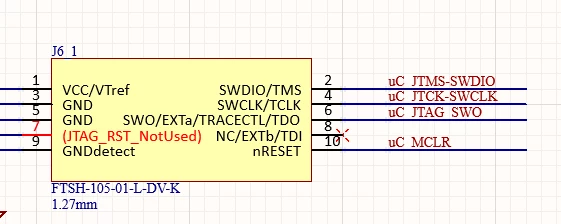

Trace Asynchronous Sw is SWO tracing which is built-in in ST-LINK for cores that support it (M4 and better) and does not require additional tools and is quite useful. What @Jan Waclawek means, is synchronous tracing:

So, the only cost to "trace asynchronous sw" is the SWO pin, is it?
KnarfB
July 8, 2024
Yes, that's the hardware cost. Plus your SW investments into tracing (logging).

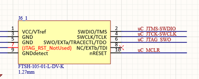

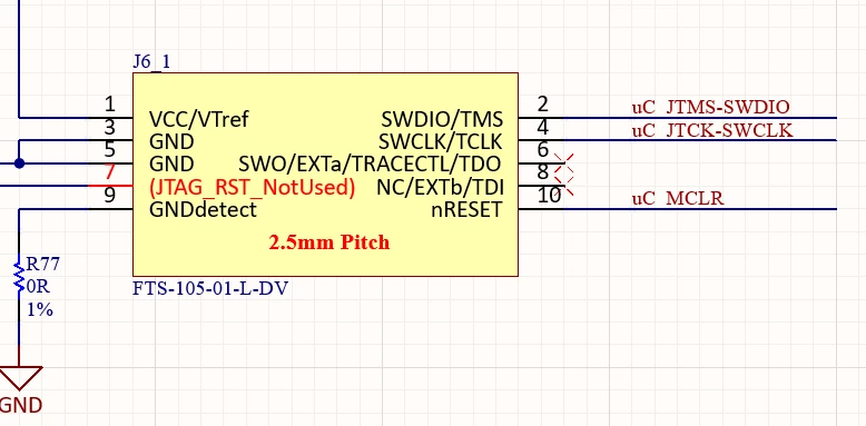

I have a Segger J-Link and am working on custom PCBs (not dev kits). Attached are both programming connectors and the signals connected to the micro.
Both PCBs have JTMS-SWDIO, JTCK-SWCLK and MCLR conencted tot he micro.
But one PCB also has the JTAG_SWO connected to the micro.
So I assume I can use SWD for both.
But what else can I use for the one PCB that also as the JTAG_SWO signal connected to the micro?
And what advantage or functionality does that extra connection provide (I assume possibly in debugging)?
Thank you :)
