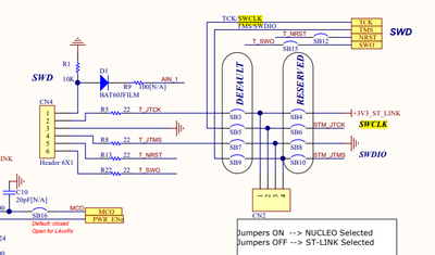

I'm working with an STM32L053r8 on a step by step know-how. My interface with the bootloader runs fine, and I am able to cover the main features provided through this interface. The issues I try to cover now is the right understanding , how the Cortex M0+ runs at assembly level. I done several tests without results today, I can continue to test with an iterative methodology; I can also use the debug port (SWD pin).
I developped an interface to do that, but at this time I didn't received any answer from the debug port. This one is built following Cortex architecture protocole (IHI0031G Debug interface architecture V5.2 architecture specification).

‎2024-12-28 2:18 AM
Hi.
Thanks to advice me with a detail of the MB1136 mother board. This detail show how the SWDIO and SWCL are tied to PA13 and PA14 of the MCU for debug.
I am connected directly on PA13 and PA14, with jumpers on CN2 out.
I'm enjoyed the debugger runs well with ST-LINK and ST Softwares Partners Packages. Then my question in short is do you provide timing diagrams of this interface, as you describe it in RM0367 page 954.
My hardware connected to the MCU's pin, doesn't get any ACK signal from the MCU. En exemple of timing chart could allow to check if bit transferts are right tuned?
In addition I attach a short list with complet ship ID of the microcontroller soldered on this board.

‎2024-12-27 2:51 AM
Hello @butterfly ,
how is your hardware is initiating the debug session?
in case of the usage of the microcontroller win one of our development boards this is being handling via the embedded STlink which is another microcontroller connected to the debug pins here is a snippet of the schematics for NUCLEO-L053R8 for reference :
The hardware you are using to initiate a debug session and the way you are doing it is quite unknown for me, and, after checking there is no identified problems with debug interface for this microcontroller.

‎2024-12-28 2:18 AM
Hi.

‎2025-01-07 8:27 AM
my understanding is that you are attempting to develop your own host SWD interface/debugger in place of existing solutions, is that right ? It is a relatively ambitious objective for which it will be difficult for us to provide support. The SWD protocol is defined by ARM and you already pointed the right document required to implement it. We don't have timings or waveforms to share, and moreover I'm not convinced it might help. If you really need it, you may probe the signals from a Nucleo board for instance. I may also suggest to look at the CMSIS-DAP firmware which could be an easy way to have a first functional implementation of the protocol if yours does not work.
Some clues which may help in the early phase of SWD protocol implementation:
- do it with the target under reset, to ensure that the required pins are dedicated to JTAG/SWD no matter the application programmed on the target
- take care of JTAG-to-SWD and SWD-to-JTAG sequences which switch the DP state after power up (DP in JTAG mode after power up)
- the first command to do after the JTAG-to-SWD sequence is a Read DP_IDCODE and the first answer from the target is the ACK of the opcode, to firstly check with an oscilloscope because your read function is perhaps initially not aligned with the turnaround period. This first ACK will mean that the DP correctly switched in SWD mode and understood the opcode, it is the very first step to mandatorily reach.
‎2025-01-07 11:17 AM
Many thanks to answer with a wide view. My understanding ARM define protocol and it could exist few differences depending implementations ( do we use a front or a level to detect bit datas?). But with an test and try methodology, I should find the right translation.
My board is based on V5.1 architecture, and didn't seem to me this level uses a software protocol to switch to DP, it started with DP, connections enabling the selecting mode. I'll check. My protocol uses today 100 clock pulses to reset, and 10 pulses to lie on standby mode. Checked with a scope I didn't get the 3 bits word ack, my own hardware staying at low level.
Thanks for the comments, and I accept your answer as a good answer.
