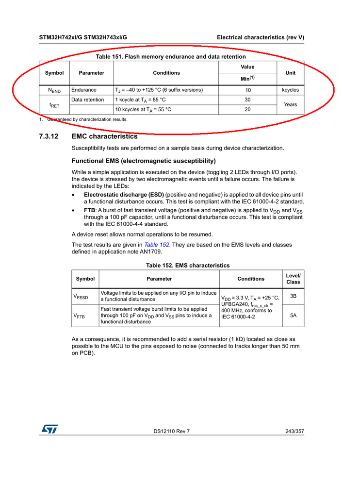

i am using stm32h743zt6 controller, what is meant by data retention in flash memory?where this parameter?how we can calculate this?

It means, how long is the programmed content of FLASH guaranteed to remain there undamaged, at given temperature )or below) and given number of erasing/programming cycles (or below).
