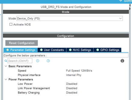

I am working on a custom board equipped with the STM32G0B1RE microcontroller. I did not design this board, but it has the following characteristics:
- the microcontroller is powered at 1.8V,

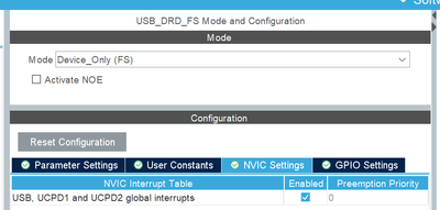

- the USB pins are enabled with the following configuration:

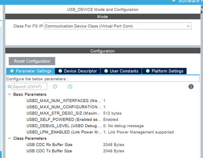

And the USB device mode and configuration:

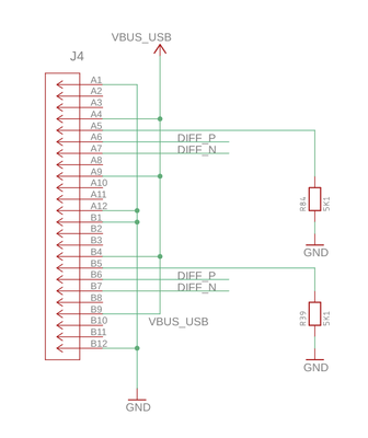

On the hardware level, the board does not have any ESD protection, but the USB data lines go directly into the microcontroller, according to the following schematic:

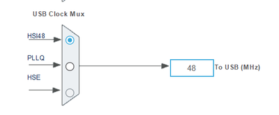

PS: unfortunately, the board does not have an HSE but only an HSI. Here is the USB clock tree:

>How can I get this to work?
Not at all , at 1.8V .
USB needs 3.3V supply , because signal level is 3v3.
For reliable USB connection usually a crystal as clock source is needed, as given in ds , note:
So : no USB here, until you have a crystal/HSE and 3V VDD supply .
