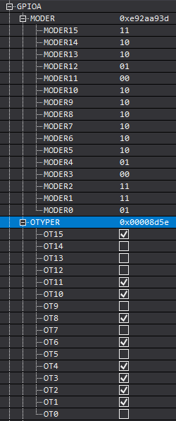

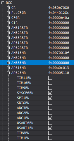

Currently we make use of three SPI busses on a STM32F405. SPI1 is a slave and SPI 2/3 are masters. I switch SPI1 to master mode and it just doesn't work. I suspect the APB2 bus but I think I have it set correctly.

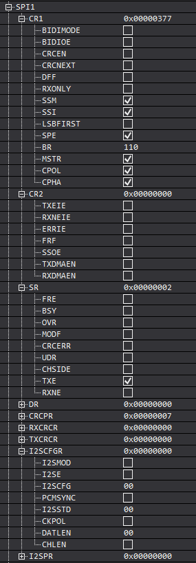

SPI register settings:

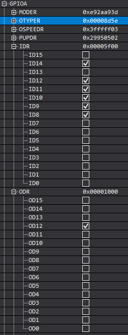

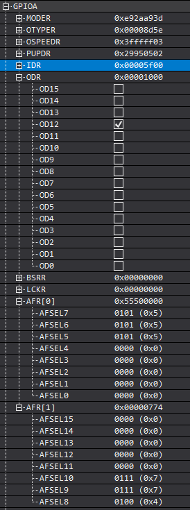

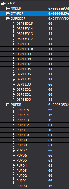

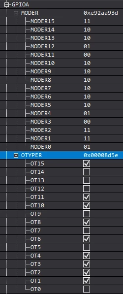

_legacyfs_online_stmicro_images_0693W00000bklpzQAA.pngPIOA settings (pins 5 = SCLK, 6 = MOSI, 7 = MISO):

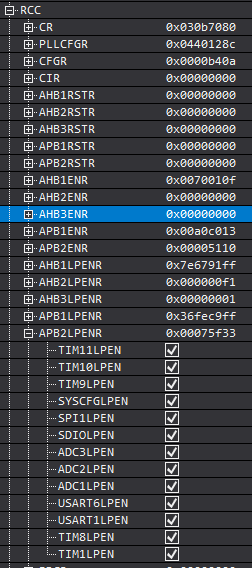

_legacyfs_online_stmicro_images_0693W00000bkhuCQAQ.pngRCC register settings:
I've played around with the prescaler CLK phase and polarity. One note, CLK never idles HIGH with CPOL = SPI_POLARITY_HIGH.
What am I missing?

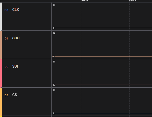

This is all I get when I am in master mode:
Also note, I am not wiggling a CS right now - just trying to see a CLK and some data.
_legacyfs_online_stmicro_images_0693W00000bkhwcQAA.pngWhen I build it in slave mode and send data to the chip I see nice wiggles in all the right places and the micro reads the data correctly and sends back data to the remote SPI master. When I am doing this mcu SPI master testing, I have the remote master device disconnected and just have the logic analyzer connected.

Are you sure you want SPI_CR1.BIDIMODE be set?
MBish.1
MBish.1Author
May 24, 2023
I tried it again with that cleared, updated the image and still the same results.

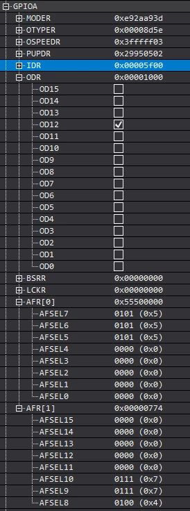

OK so set SCK to GPIO Output and try to wiggle it "manually" and observe.
MBish.1
MBish.1Author
May 24, 2023
I can't wiggle the old CLK and SDI. I can wiggle SDO.
Bob S
May 24, 2023
What external device is connected to the SPI signals? Is whatever used to be the master still connected? If so, it is probably driving those signals.
MBish.1
MBish.1AuthorBest answer
May 24, 2023
This was a hardware issue.
