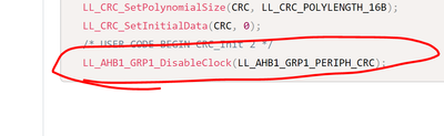

And Im using STM32CubeIDE with a STM32G0 microcontroller that have a CRC peripheral unit, so i think that i config correctly the peripheral:
/* USER CODE BEGIN CRC_Init 1 */
 LL_AHB1_GRP1_EnableClock(LL_AHB1_GRP1_PERIPH_CRC);
 /* USER CODE END CRC_Init 1 */
 LL_CRC_SetInputDataReverseMode(CRC, LL_CRC_INDATA_REVERSE_NONE);
 LL_CRC_SetOutputDataReverseMode(CRC, LL_CRC_OUTDATA_REVERSE_NONE);
 LL_CRC_SetPolynomialCoef(CRC, 0x3D65);
 LL_CRC_SetPolynomialSize(CRC, LL_CRC_POLYLENGTH_16B);
 LL_CRC_SetInitialData(CRC, 0);
 /* USER CODE BEGIN CRC_Init 2 */
 LL_AHB1_GRP1_DisableClock(LL_AHB1_GRP1_PERIPH_CRC);

August 24, 2023
This disables the CRC clock. Don't do that until you're done with it.

> I dont disable the clock until i have finished the calcs.
This disables the clock after initialization, no?
Dosan
DosanAuthor
August 28, 2023
Yes, i disable the clock to get better power consumption, but when i use the CRC is enable.
Thanks,
