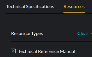

Hi.
I an looking for some info about CoreDebug and DWT registers in M3 and M4 series. Can you tell me where i can read about it? There is nothing about it in RM

Hello @sholojda
CoreDebug and DWT registers are part of the ARM Cortex-M3 and Cortex-M4 core peripherals, you can read about it in the ARM Cortex-M3 and Cortex-M4 technical reference manuals.
For CM4: Cortex-M4 Technical Reference Manual
For CM3: Cortex-M3 Technical Reference Manual
