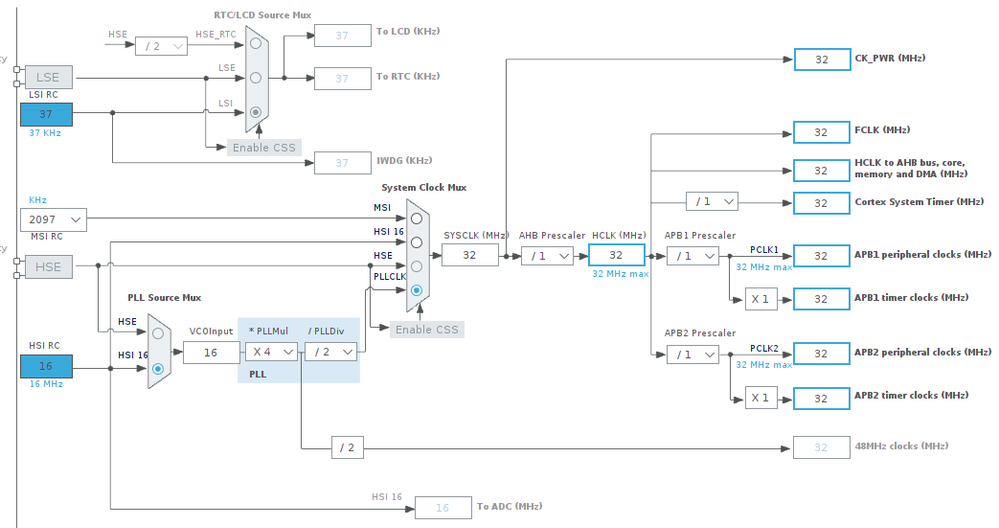

Hey guys and gals! I am facing a persistent problems when configuring system clock on the STM32L152 to 32MHz using SPL. It smoothly runs at 24MHz but always freezes when making it to run at its maximum freq.
The MCU's max clock frequnecy is 32MHz and it runs just fine when configuring the clock using STM32CUBE IDE and HAL. The intention is to run it from HSI (16MHz) via the PLL in this way:
It refuses to work in my SPL-based code, although the procedure seems to be the exact analogy to the HAL code:

It never goes beyond the last while on line 23. All the code I had googled is mostly related to other MCUs (mostly F103), and there seems not to be anything that different in the architecture. Could any of you, please spot a difference or a missing piece and advise? Cheers!

Pretty sure you have to enable the 64-bit fetch
Here for HSE/PLL in SPL examples

I'd try
FLASH_PrefetchBufferCmd(ENABLE);
FLASH_ReadAccess64Cmd(ENABLE);
FLASH_SetLatency(FLASH_Latency_1);
PWR_VoltageScalingConfig(PWR_VoltageScaling_Range1);

Yes! That worked! The missing parts were the prefetchBuffer + readAccess64. Thank you so much! =)
For future reference the complete working code is right here:
