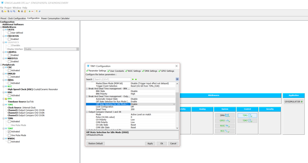

I'm trying to have complementary outputs with dead-time on CH1/CH2/CH3 and CH1/CH2/CH3N using TIM1 and Output Compare Mode on STM32F429.
So I configured STM32CubeMX like in the picture below :
And there is the portion of my code :
(for testing purposes, a button press changes the state of CH1/CH1N)
void TIM1_ItUpFcn()
		if (HAL_GPIO_ReadPin(GPIOA,GPIO_PIN_0)==1)
			TIM1->CCER = 4;
		else
			TIM1->CCER = 5;
That code changes CC1E/CC1NE bits.
As a result,on the scope, I do get my complementary outputs on CH1 and CH1N, they invert each other when I press the button, but with no deadtime! I don't understand why i don't have that deadtime, like explained below :

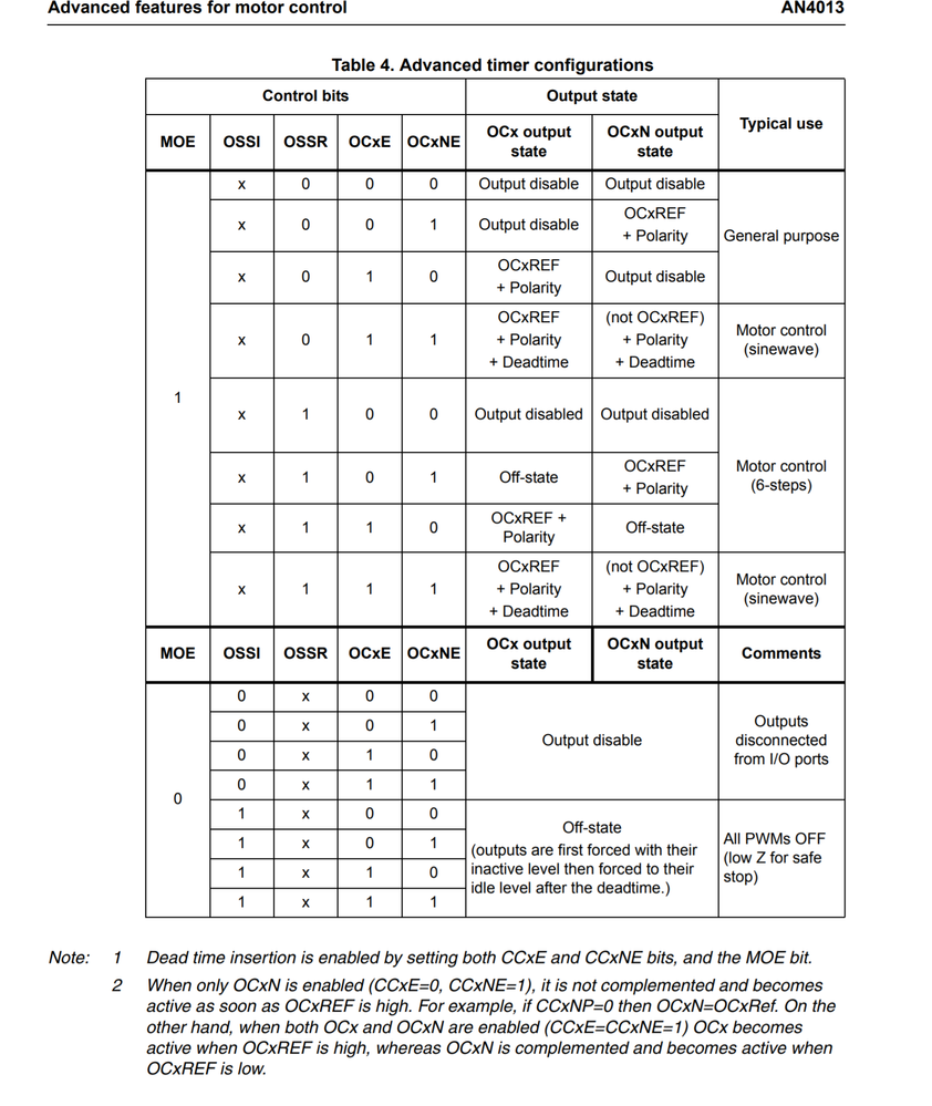

    Best answer by waclawek.jan
    So you have both CH1 and CH1N enabled in CCER, and CH1 set to OC1M = 0b001 i.e. set to active when match.
    After enabling the timer, you should then see only one edge, first a falling one on CH1N, and then a rising one on CH1, delayed by 320 timer cycles.
    You maybe expect that there is dead time inserted when you manipulate the outputs through CCER - this is not the case; dead time is related to the OCxREF signal and that does not change when you change CCER; see the Complementary outputs and dead-time insertion chapter in RM.

    Read out and check/post the content of all TIM registers (mainly BDTR)

    In debug mode, BDTR=0x0000ACC8 (‭1010 1100 1100 1000‬)
    Damien Ratazy
    August 14, 2018
    Okay, so I finally found how to turn ON CH1/CH2/CH3 and CH1/CH2/CH3N with the appropriate deadtime, using CCMR1 and CCMR2 registers (by setting bits 4-6 for OC1M, bits 12-14 for OC2M on CCMR1, bits 4-6 for OC3M on CCMR2).
