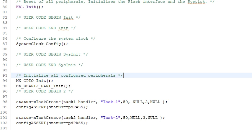

I am using NUCLEO-F410RB Board embedding STM32F410RBTx Device and I was trying to port the FreeRTOS bare minimum(kernel w/o CMSIS) api here and it is throwing me an error when I create a bare minimum task(no global variables or arrays in the main either.)
Note: It is building properly when I am not using the FreeRTOS Apis.

Any thoughts on what is missing over here?

Edit the linker file to increase the size of the ram, then compile it, then see what's taking up so much space.
Anare.1
Hey!! @TDK
Actually heap_4 was taking so much memory in my 32KB system that I ha to limit the heap to minimal size.
I modified the FreeRTOSConfig.h and it is compiling now for gods sake!!
