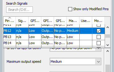

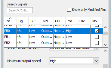

I have modified clock speed in "GPIO Mode and Configuration" tab. Please find the screen shots. For now I tried with PB0 as "high" and PB12 as "medium". Also I tried the same code as you suggested but still same output (00000000).
