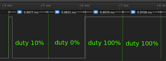

Hello.
I have been writing test code for motor control software.
The problem is two 100% duty pulses generated when I give only one pulse.
Could you tell me the cause and how to solve this problem?
The test environment and code are as follows.
[Test environment]
- NUCLEO-F446RE
- NUCLEO-F303K8 (same problem has occurred using another board)
- STM32CubeIDE 1.3.1
[Test code]
The part of the related code is as follows.
/* USER CODE BEGIN 2 */
 uint16_t pulse[] = {100, 0, 1000};
 HAL_TIM_PWM_Start_DMA(&htim1, TIM_CHANNEL_1, (uint32_t *)pulse, sizeof(pulse) / sizeof(uint32_t));
