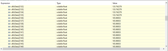

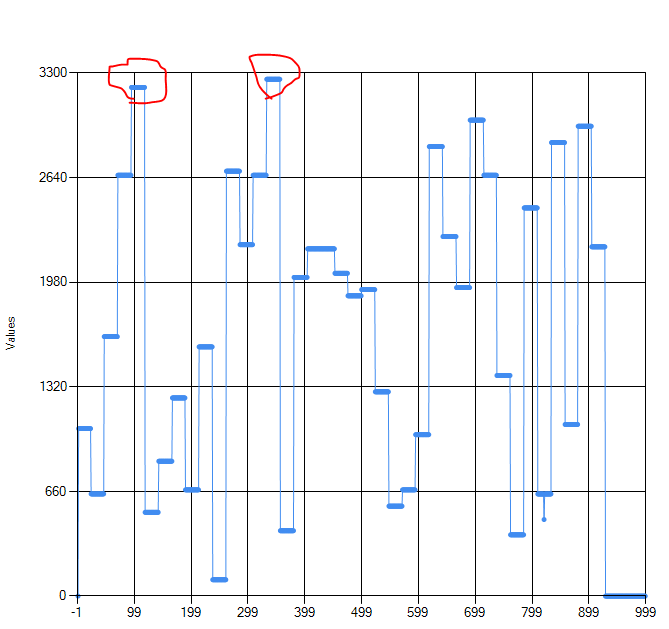

Background: I use the stm32373c evaluation board to make project. One part of the project is to use the 16bit SDADC to acquire sinewaveform generated from function generator and send the data to pc sw thr. uart. I follow the evaluation board example called "SDADC_Voltmeter" and modify the code for my own use.
I found I cannot get the whole sinwaveform because many data has the same value, they are not continuous. I am not sure if there's important SDADC configuration setting I need to notice?
The attachment is the waveform pic get from pc sw thr. uart, inner debug screenshot and the "SDADC_Voltmeter" example code.
Thanks for help!
 I also try to use the Inner debug to watch the data acquired from sdadc, unfortunately they are the same issue... many number is the same, not continuous...0693W00000FBpM5QAL.png

Perhaps I missed the USART stuff. The project is incomplete, and no point posting a copy of the unmodified example files. Find a better example for the task at hand.
If you want to capture wave forms you'd do much better using DMA to take periodic samples, not spin in a loop, somewhat asynchronously and post measurements to a slow serial connection.
You'd want a sample rate at least twice that of the wave form you're trying to capture to meet the Nyquist criterion

Actually in the project, I create a global data array and put the array in the loop. During the loop, the data array will be updated every time after acquired a new value. I also add a timer to save the data every 100ms. The uart will transmit the saved data out when serial port receive a proper command byte.
As the original code is long and messy, I just collect some useful code here. Thanks for the help!

Up to here, i just realized probably the global data array cannot save the real updated number as the loop runs too much faster...??? How do u think? Thanks!

I think i found the reason why board cannot acquire high speed adc data. As the code is based on example, the original example code set the gpio speed to low. I alter it to high, then looks like it works.
