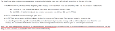

You’re not supposed to worry about the structure of the frame. The peripheral is doing it. The frame acknowledgement is performed by any node receiving the frame no matter it’s the recipient or not. The acknowledgement has no relation with the ID but with the consistency of the frame structure and fields/errors etc... This is the CAN protocol defined by Bosch and it's not related to the STM32 product.
From the link: https://www.kvaser.com/can-protocol-tutorial/
Hope I answered your question.

The frame is acknowledged by at least one node on the bus even it is not the frame recipient. The frame structure needs to be correct to be acknowledged.So what you are seeing is a normal behaviour
