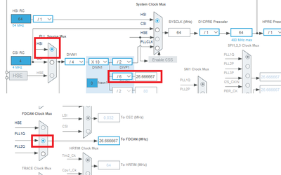

To me, I have a doubt regarding the bitrate:
Are you sure this is the intended CAN bitrate? 115440 ? this is not a regular CAN bitrate.
if yes do you have the same bitrate on both CAN nodes?
Also, it's not recommended to use HSI for CAN communication. You need an external precise clock either a crystal or crystal oscillator:
Need also to share your schematics including the transceiver.

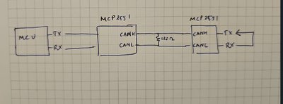

Just a small query, this project is to test the CAN communication. Is it possible to do this with one board and 2 transceiver ( loopbacking TX and RX of the second transceiver so that whatever data you transmit is getting received ) ?

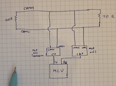

its a hand-drawn schematic.
Yes you can use 1 Nucleo that has at least 2 CAN controllers. You can't loop the TX and RX on the CAN transceiver. Technically you need two 120 ohm resistors on either ends of the CAN bus lines.
This link has an image showing the terminating resistors at each end with Node A and Node B connected to the bus.
https://www.rs-online.com/designspark/a-can-bus-primer-part-1-introduction

Hello;
No this is not the right HW connection:
@Aswin wrote:
Here you connected two transceivers to the same CAN instance. You need two CAN/FDCAN instances for example CAN1 and CAN2 and two transceivers. For both MCUs you have two CAN instances each.
This is the minimum hardware and connection to establish between two CAN nodes:
