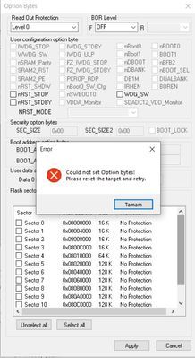

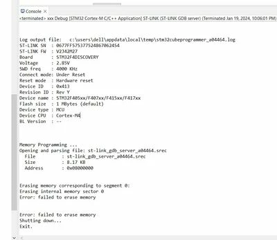

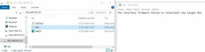

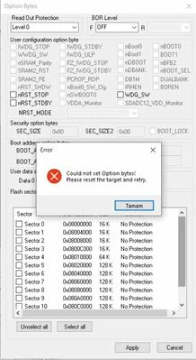

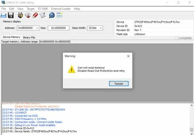

Hello. I have an STM32F407 development board. While I was getting used to this card last week, the card put itself into memory read protection. When I try to debug or throw code, the attached warning appears and the attached Fail file is created. Even though I try to set the RDP level to Level 0 (AA) in the "option bytes" option with the STLink utility and STMCube Programmer, it does not work. and the same warning happens again. RDP level appears as FF in STMCube Programmer. I looked at all the form sites. I did all the suggestions but it didn't work (updating STMutility, etc.). How can this situation be corrected? Has anyone experienced this situation before? Can you help?

based on the described symptoms it seems a hardware problem caused by non correct loading of the Options Bytes ( factory programmed) and non user.  Here is what I suggest you for a sanity check :
