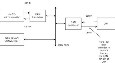

To clear the above points I also adding the block diagram of my system.

Hello @skhanna
My first question is: what is the clock source of FDCAN? if you are using cubeMx please attach your ioc file.
2024-08-20 3:28 AM - edited 2024-08-20 3:31 AM
Thanks for reply,
I am using the external 8 MHz crystal oscillator available on NUCLEO-H753ZI. and sorry IOS file is not available. CAN frequency is 50MHz.
PLease see this for more clarity–All device are connected as shown in my previous post figure.
