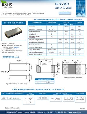

i am using a ECS-.327-9-34QCS-TR with a 1.5pF caps on a STM32H743BIT6.
I want to know the exact method to calculate the right value for the oscillator caps.
because my RTC is off by 5mSec.

calulate im ppm deviation, look in ds of the crystal, compare...
the H7 have correction in 0,6ppm steps (afair), but first need exact actual deviation. then set correction factor.
+ the caps - see in ds of crystal, load cap.

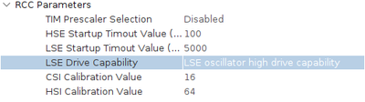

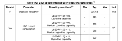

but : first set LSE drive level high ! then use cap size, matching the data of your crystal. then check deviation again.
ie.
your crystal has 9pF nominal load. so 12.5pF could be good - but only work with high drive level. try it.

ad said by @AScha.3  This Crystal is with CL=9pF and good pullability level if you have a good PCB Cs ( parasitic capacitance) should not exceed 3 to 5pF so CL1 and CL2 should be in range of (9-3 ) * 2 =  12pF and (9-5) * 2 = 8pF .  You need also to activate by software the High driver level as by default  after Power up / backup domain - it is set to low drive mode .

So I tried on High driver level with caps 12.5pf and it boots and stuck and restarts.
STOne-32
November 7, 2023
Try to bypass the timeout just for debugging and read back the drive level by software to check the register if really set to high drive mode . If not power off and then On the device .

fyi i did use High driver level
nadeemtamuk191AuthorBest answer
November 14, 2023
i used a 4pf for each load caps to avoid ringing and adjusted in the STM cube to get the proper value
4PF
my oscillator can handle 9PF, so 5pf is the IO cap according to the datasheet in the MCU
9-5 = 4

Just read AN2867 - Oscillator design guide for STM8AF/AL/S, STM32 MCUs and MPUs.
Use only oscillators listed in AN2867, but even then you may experience problems.
External capacitors generally should be 1/2 of the specified crystal capacitance since two capacitors are required.
