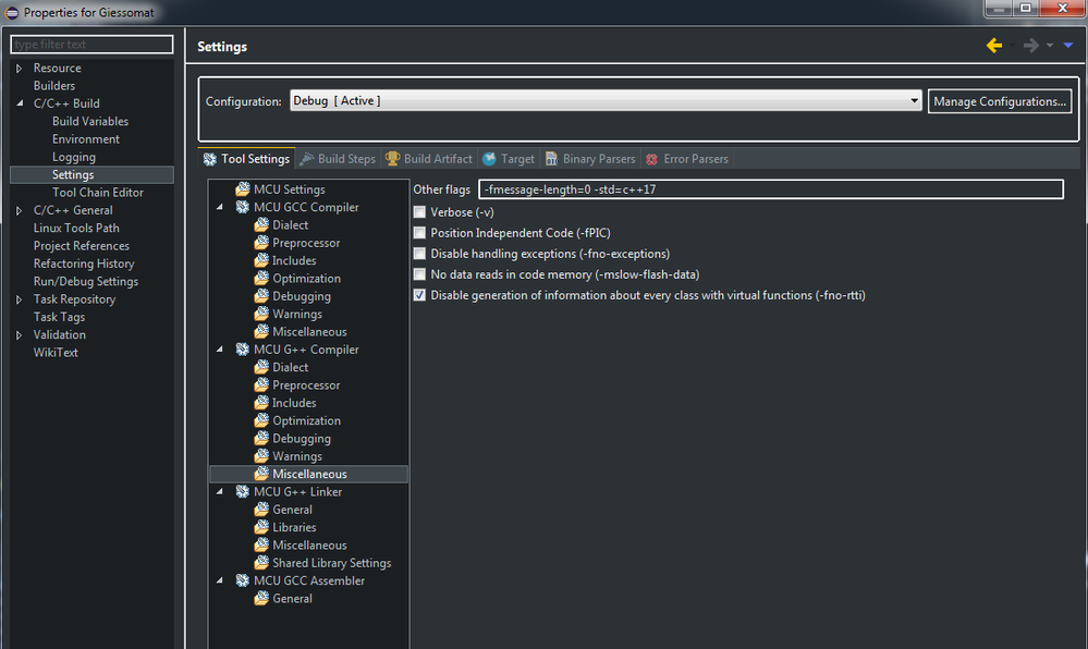

Compiler flags:
Invoking: MCU GCC Compiler
xxx\Debug
arm-none-eabi-gcc -mcpu=cortex-m4 -mthumb -mfloat-abi=hard -mfpu=fpv4-sp-d16 -std=c11 '-D__weak=__attribute__((weak))' '-D__packed=__attribute__((__packed__))' -DUSE_HAL_DRIVER -DSTM32F429xx -I'xxx/Giessomat/Inc' -I'xxx/Giessomat/Inc/User' -I'xxx/Giessomat/Inc/User/debug' -I'xxx/Giessomat/Inc/User/Testcases' -I'xxx/Giessomat/Inc/User/display' -I'xxx/Giessomat/Inc/User/display/img' -I'xxx/Giessomat/Inc/User/SD' -I'xxx/Giessomat/Inc/User/SD/XML' -I'xxx/Giessomat/Drivers/STM32F4xx_HAL_Driver/Inc' -I'xxx/Giessomat/Drivers/STM32F4xx_HAL_Driver/Inc/Legacy' -I'xxx/Giessomat/Middlewares/Third_Party/FreeRTOS/Source/portable/GCC/ARM_CM4F' -I'xxx/Giessomat/Middlewares/ST/STM32_USB_Device_Library/Core/Inc' -I'xxx/Giessomat/Middlewares/ST/STemWin/Config' -I'xxx/Giessomat/Middlewares/ST/STemWin/inc' -I'xxx/Giessomat/Middlewares/ST/STM32_USB_Device_Library/Class/CustomHID/Inc' -I'xxx/Giessomat/Drivers/CMSIS/Device/ST/STM32F4xx/Include' -I'xxx/Giessomat/Middlewares/Third_Party/FatFs/src' -I'xxx/Giessomat/Middlewares/Third_Party/FreeRTOS/Source/include' -I'xxx/Giessomat/Middlewares/Third_Party/FreeRTOS/Source/CMSIS_RTOS' -I'xxx/Giessomat/Drivers/CMSIS/Include'  -Og -g3 -pedantic -Wall -Wextra -fmessage-length=0 -ffunction-sections -c -fmessage-length=0 -MMD -MP -MF'Drivers/STM32F4xx_HAL_Driver/Src/stm32f4xx_ll_sdmmc.d' -MT'Drivers/STM32F4xx_HAL_Driver/Src/stm32f4xx_ll_sdmmc.o' -o 'Drivers/STM32F4xx_HAL_Driver/Src/stm32f4xx_ll_sdmmc.o' '../Drivers/STM32F4xx_HAL_Driver/Src/stm32f4xx_ll_sdmmc.c'
Building file: ../Drivers/STM32F4xx_HAL_Driver/Src/stm32f4xx_ll_usb.c

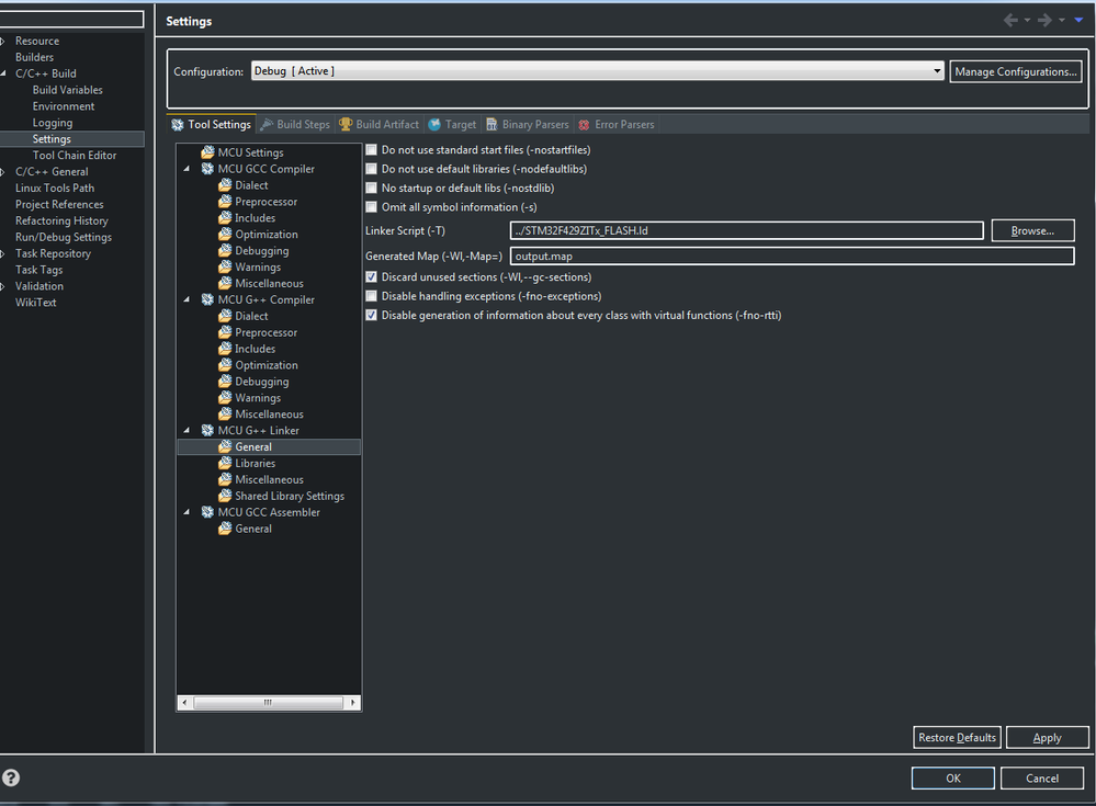

Linker flags:
Building target: Giessomat.elf
Invoking: MCU G++ Linker
arm-none-eabi-g++ -mcpu=cortex-m4 -mthumb -mfloat-abi=hard -mfpu=fpv4-sp-d16 -L'xxx/\Giessomat\Middlewares\ST\STemWin\Lib'  -specs=nosys.specs -specs=nano.specs -u_printf_float -T'../STM32F429ZITx_FLASH.ld' -Wl,-Map=output.map -Wl,--gc-sections -fno-rtti -o 'Giessomat.elf' @'objects.list'  -lSTemWin540_CM4_OS_GCC -lm
Finished building target: Giessomat.elf
With these flags exceptions should be enabled right? So why am i not catching this exception?

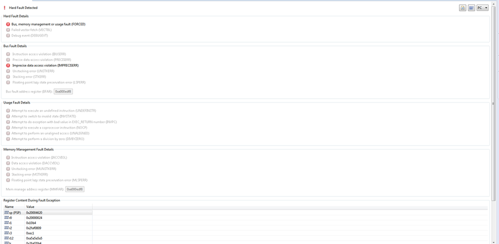

    >>However I'm always running into a hard fault. I'm expecting a bad alloc exception instead.
    So *what* is actually faulting? See processor registers and disassemble faulting instructions.
    Does the compiler expect some additional handlers or infrastructure to implement the functionality you expect?

    hey,
    the faulty part is that my vector get's larger than the available free heap. The vector probably trys to allocate memory from some protected area.
    How can i diagnose the hard fault further. There is no stack trace. (But I'm very sure that the vector allocation is the problem. If i reduce the number of elements added to the vector (i.e instead of 50000 only 10000) everything works fine)
    This is just a test to check out the limits of the vector class.
    This code is not being used in the actual project.Therefore this code does not require any initialisation.
    However how can i safely use a vector if i am always running into a hard fault once the vector is too large?

    How about instrumenting the HardFault_Handler so you get useful data?
    And adding code into _sbrk in syscalls.c or whatever is acting as the allocator. Figure out where the pool is, and how large it is.
    If you can isolate where it fails you can try an unwind the call stack, or perform static analysis of the call tree.
