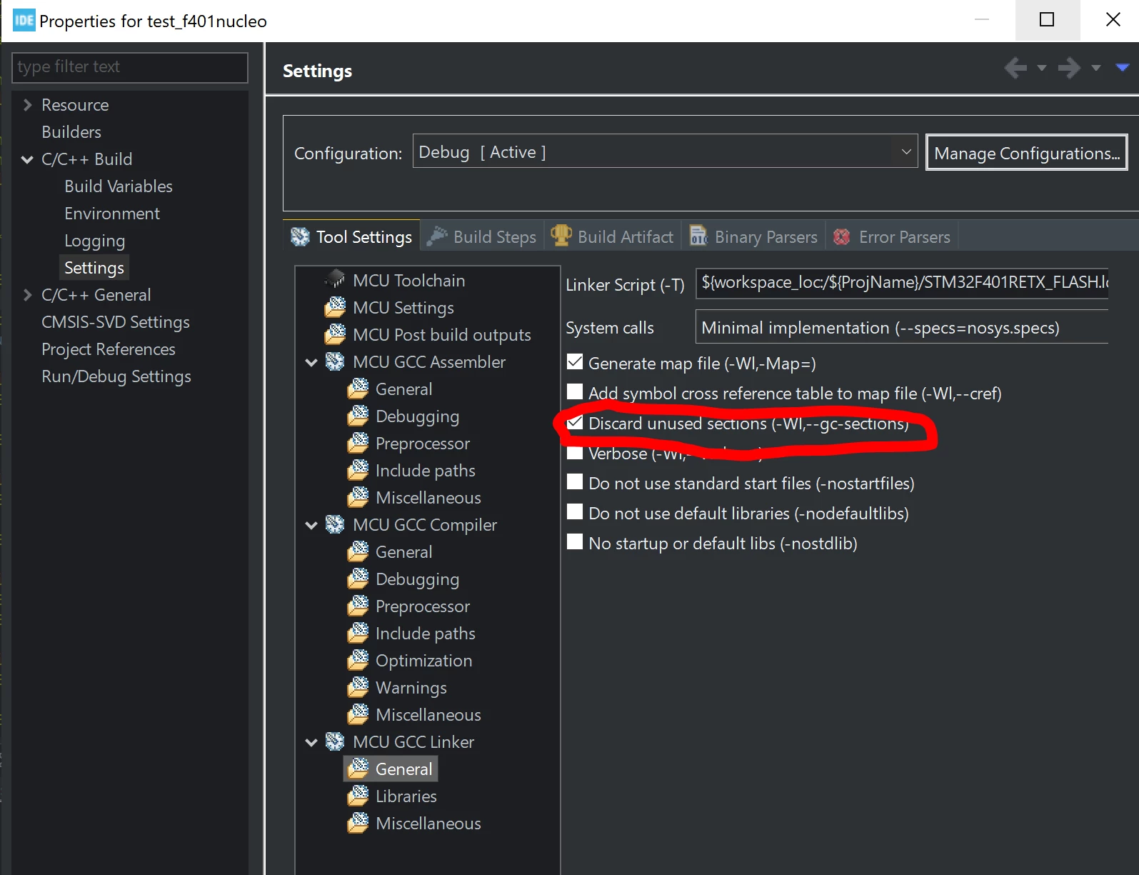

I have been working on a STM32F091 C++ project just to get an idea code size, and I noticed that the size of the binary is huge even when optimisation is set to (-Os). I think its because the compiler is bringing in everything, even when certain functions, and section are not being used, but! I’m not sure.
Generally speaking, is there a way if streamlining my project to cut down on code?
You can open up the map file and figure out what's taking so much space. Ensure your linker discards unused code (-WL,--gc-sections)

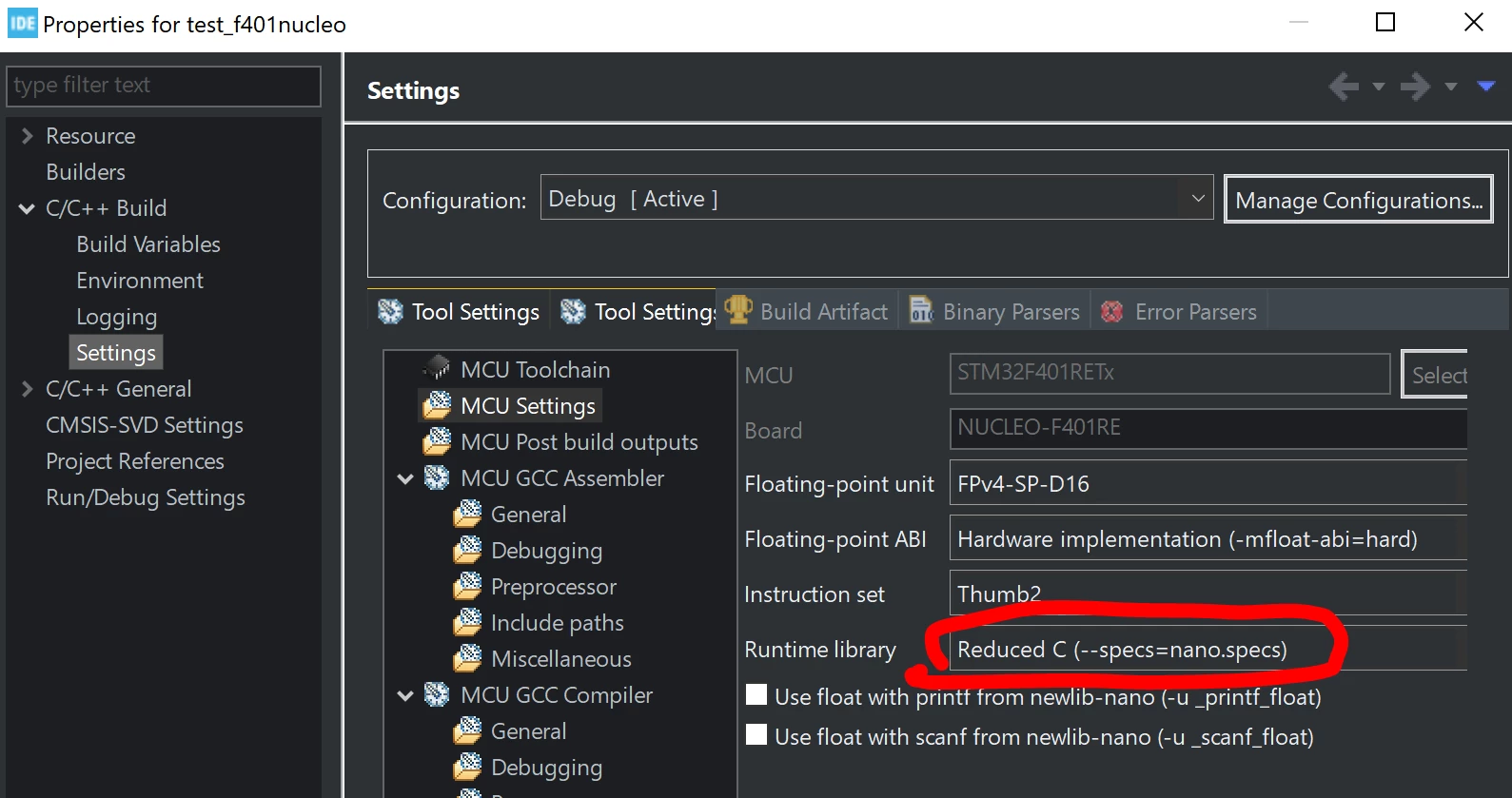

Use a reduced library such as nano (--specs).

Thanks for your answer TDK.
Where do I place (-WL,--gc-sections) and  (--specs) in the cubeIDE settings.
September 7, 2021
In project settings.

September 9, 2021
ok, I checked my settings, and that's the way they are set up already. This code I'm using compiles for a mega2560 AVR at just under 128K, but as it is, ported to STM32F091, it generates 241k of code. That a big difference.

September 11, 2021
Just to complete this thread, one of the files contained an #include <iostream> statement.
When I removed this, the code size came down to 88K, which seems about right for this project size.
