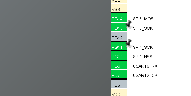

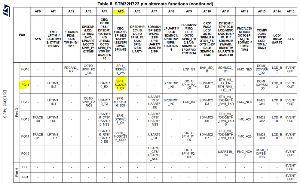

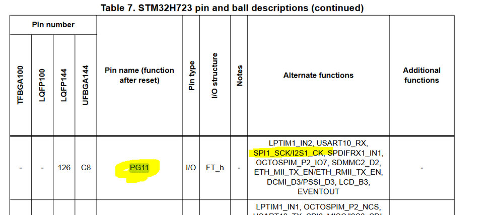

I am making SPI DAC update function, and I could not get PG11 to output SPI1 clock.
While if I switch to PB3 pin, all is perfect. (this is alternate pin for SPI1)
If I toggle PG11 as GPIO, I get waveform so where is no short or something similar. Errata is also mute about this....

> LL_GPIO_SetAFPin_0_7(GPIOG, LL_GPIO_PIN_11, LL_GPIO_AF_5);
For pin 11, you want LL_GPIO_SetAFPin_8_15.
LL_GPIO_SetAFPin_8_15(GPIOG, LL_GPIO_PIN_11, LL_GPIO_AF_5);

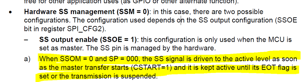

> I don't understand why ST can't include NSS hardware that would be handled with DMA transfers, it is just a few more triggers inside silicon to produce... NSS handling is just a mess.
The STM32H7 series has newer SPI peripheral where the SS pin can probably act as you want. Have you tried it?

So changed:
spi_initstruct.NSS = LL_SPI_NSS_HARD_OUTPUT;
LL_SPI_SetNSSPolarity(SPI1,LL_SPI_NSS_POLARITY_HIGH); //Or low...
LL_SPI_SetTransferSize(SPI1,1);
LL_SPI_SetMasterSSIdleness(SPI1,2);
LL_SPI_Enable(SPI1);
LL_DMA_EnableStream(DMA1, LL_DMA_STREAM_7);
LL_SPI_StartMasterTransfer(SPI1);
And lets not forget PIN init:
 LL_GPIO_SetPinMode(GPIOG, LL_GPIO_PIN_10, LL_GPIO_MODE_ALTERNATE);
 LL_GPIO_SetAFPin_8_15(GPIOG, LL_GPIO_PIN_10, LL_GPIO_AF_5);
 LL_GPIO_SetPinSpeed(GPIOG, LL_GPIO_PIN_10, LL_GPIO_SPEED_FREQ_HIGH);
 LL_GPIO_SetPinPull(GPIOG, LL_GPIO_PIN_10, LL_GPIO_PULL_DOWN);
 LL_GPIO_SetPinOutputType(GPIOG,LL_GPIO_PIN_10,LL_GPIO_OUTPUT_PUSHPULL);
But I don't see any activity on NSS pin...
What I am doing wrong ?
