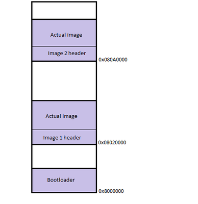

Hi everyone, I'm developing a bootloader that works like this. I was inspired by the example: https://github.com/pramodk51/bootloader_for_stm32f4.
I developed this initially on Nucleo F439ZI for the test phase and I managed to implement it with the addition of DFU functionality. The principle was simply to send a program that lights a led per uart that the bootloader would store and then go to this memory location to make it work (2 slots, one for the recent version and the other for the backup).
Note: I didn't develop the whole thing in the same code, I have bootloader code and application code, so 2 linker scripts etc ...
Once the test was functional and robust, I decided to integrate it into my personal project. My application this time is much more complex than turning on a LED, it uses FreeRTOS and is also much larger (but respects the size specified in the slot).
In terms of the application I've reproduced exactly the same operation so that it adapts to the slot automatically with the
SCB->VTOR
. Obviously the code I generate is adapted to the slot in which it will be placed using the linker script.
So when it comes to restarting, everything should work in the same way as when I carried out my tests on nucleo. However, I'm not getting any results from my tests.
My application program won't launch even though the bootloader redirects to the correct slot and updates the reset handler (check against the .map). But after that I have nothing. I have an IWDG function on the bootloader and the application and at the end of each WDG delay I loop back to the bootloader because nothing happens.
My problem is that I'm reproducing exactly the same pattern as during my configuration tests and the result is different.
I suspect a difference in treatment when using FreeRTOS but I haven't found anything on the subject. Are there any parameters that need to be managed to ensure correct operation?

Is your header size linker set 1K ? But primary question is how plan you have to load firmwares?

Yes, my header is 1K. It worked during my tests on nucleo and the ‘blink’ application. As far as the firmware is concerned, the final aim is to download it via UART (sent by an ESP32). This has already been done and is working on the test version.
This is what seems strange to me: everything worked perfectly on a ‘blink’ application but with my FreeRTOS application nothing works any more. Attached is my script linker for more information.

I tested the entire code on Nucleo. I'll explain the tests again:
UT = St Link utility
- Test 1: Programming the bootloader to address 0x08000000 with UT and programming the blink program to address 0x08020000 (1st slot) also with UT. The bootloader returns the blink and works even after reset (nucleo button).
- Test 2: Addition of the blink program at address 0x080a0000 (2nd slot) with a higher version because the bootloader starts the application with the most recent version (version present in the application header). Functional test in slot2, even with the Nucléo button reset.
- Test 3: Using the DFU UART. Using a python script to send the .bin files for the blink programs. (To be precise, I created a linker script adapted to each slot and the bootloader will decide which .bin to use at the time of the DFU. This is the best way I've found to manage this dynamically, even though there may be simpler ways). Functional tests, sending and writing to memory went perfectly and start-ups according to versions worked.
- Test 4 (final nucleo): Using the DFU UART with the ESP32. This time the bin firmwares were communicated via local wifi to the esp, which sent them via UART to the STM32. Same functional result on the 2 slots.
- Test 5 (integration into the project): Implementation of the same general configuration on the application program, use of the same bootloader but no start-up. However, the application program launched at address 0x08000000 launched very well without any bugs. The only difference between the 2 programs? File size -> blink = 13kB | App = 103kB (383kB per SLOT on Linker script | Sector 5.6.7 -> slot1 with 128kB per sector and slot2 -> Sector 9.10.11 with 128kB per sector) and FreeRTOS present on the integration program and not present on the blink program. Does FreeRTOS have any special configurations for this?
