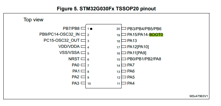

Hi!
I'm using STM32G030F6P6 TSSOP-20 and I notice that BOOT0 pin and SWCLK pin are the same pin. If I want to program the STM32G030F6P6 MCU, then I only need SWDIO and SWCLK and NRST pin and forget about the BOOT0 pin because BOOT0 pin is not avaiable if I have SWDIO?
Best answer by TDK
It depends on how BOOT0 is wired and the relevant option bytes. I would imagine the nucleo board is set up to run user code automatically, but I'm not going to double check.
6 replies
June 10, 2021
You don't need BOOT0 to program.
You will need to tie BOOT0 low to boot to user code, or set the corresponding option bytes to boot to user code.

Thank you for your answer. I don't know what "user code" is, but I assume you mean programming with UART?
OK! Then I know that I can ignore the BOOT0 and only use ST-LINKV2 to program the MCU above via SWDIO and SWCLK and NRST.

June 10, 2021
The chip can either boot to system memory (aka bootloader) or the flash (aka user code). BOOT0 (or option bytes which override it) selects which one is selected.

June 10, 2021
So programming with ST-LINKV2 (e.g Nucleo board) then I will boot from user code?

TDKBest answer
June 10, 2021
