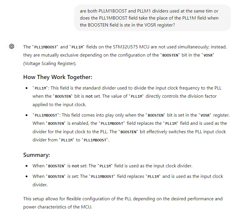

further question / observation:
Reference manual documentation is very confusing on both the purpose of the VOSR_BOOSTEN field and the associated PLL1MBOOST field in PLL1CFGR register.
The field is labled "PLL1MBOOST " yet the values of the field indicate the input source frequecy is being reduced by division (1/1 to 1/16) by even numbers (except 1).
In addition, in the same register, "PLL1CFGR", the "PLL1M" field is the "prescaler" in front of the multiplier.  As an asside, the multiplier value is configured with the PLL1DIVR PLL1N field - how confusing is that?
So now I have two fields that seem to divide down the source clock before it enters the multiplication stage.   Do these fields compound each other?  Does one replace the other when PLL1MBOOST is enabled?  Both fields have values between 1 and 16.
All in all I'm still very confused about how all this is supposed to work and I suspect I'll only know by doing exhaustive experimentation - which theoretically the reference manual should prevent us from needing to do.
Anyone know how all this works?  Or even better, knows a source of clear and accurate documentation?

Ha - might have answered my own question - here's my interaction with ChatGPT:
If this is correct it's really kind of amazing!!!
waclawek.jan
August 19, 2024
Why do you think ChatGPT "knows" more than what's in the RM?
Anything else is ChatGPT's hallucination. I though this is pretty clear by this point.
Instead, at this point, you should contact ST directly, through FAE or the web support form.
ShawnP
ShawnPAuthor
August 19, 2024
Well perhaps I'm just not yet good at digging the information above out of the reference manual.
Perhaps you could show me where in the reference manual it specifically says that when you set BOOSTEN that the chip switches from using the values in PLL1M and uses the values in PLL1BOOST instead.   It might be there but after hours of searching I turned to this forum - and got no answers.
I'd be happy to be schooled on better approaches to get the answers I need than coming to this forum.
Any tutoring from the wise "guru" would be welcome.

August 26, 2024
Hello @ShawnP
In the section 10.5.4 Dynamic voltage scaling management you will find the required sequence to use the EPOD (embedded power distribution) booster , indeed it is mandatory to follow it.
>>the BOOSTRDY bit does not get set until after MSIS is enabled
I think it is not mandatory that the PLL source is MSI, it can also be HSI or HSE, but PLL must be enabled with clock selected as explained in the sequence.
>>it's strange that I don't see the sample applications setting BOOSTEN yet having no difficulting running at 160MHZ...
the fact that they are running properly does not mean it will always work properly. When increasing the frequency, the consumption of all logic supplied by VCORE increases, and the consumption depends on the number of enabled peripherals, their frequency, the process and the temperature.
The behavior above 55 MHz, whatever enabled peripherals and PVT conditions  are only  guaranteed if Booster is enabled. It does not mean that it cannot work in typical conditions, but it is not guaranteed.
>>Regarding your question about PLL dividers;
The booster needs a clock between 4 and 16 MHz, as explained in 10.5.4 Dynamic voltage scaling management . PLL1MBOOST divider is only used to generate the booster clock at required frequency. There is no link with the PLL1 division and multiplication factors. The PLL input clock is used because we are sure that the PLL is already used when frequency is increased above 55 MHz, so we can reuse the PLL input source selection instead of another source selection just for the booster.
I hope that makes things a bit clearer!
