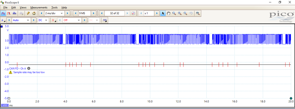

i have STM32H7 Nucleo board, i'm trying to implement CAN-FD. so i was trying to send some data over CAN-FD to CAN-Analyser. For bit timing calculation i'm using STM32H743I-EVAL example as reference .
fdcan_ker_ck - 20Mhz, Time_quantum- 50ns, Propagation_segment- 23 tq, Phase_segment_1- 8 tq, Phase_segment_2- 8 tq, Synchronization_Jump_width - 8 tq, Bit_length - 2 us, Bit_rate- 0.5 MBit/s.
this i used it for both nominal and data..But when i use it can analyser the bit timing doesn't match.i used these following documents for reference but still couldn't solve it

I'm getting some data in analyser but couldn't able to decode the data, this is because of bit timing issue or anything else. i'm attaching the screenshot, please have a look into it.
Auto-retransmission is happening because my Nucleo-board is not getting any acknowledgement

Issue solved, there is issue with the crystal oscillator.Now it works fine with internal oscillator.
