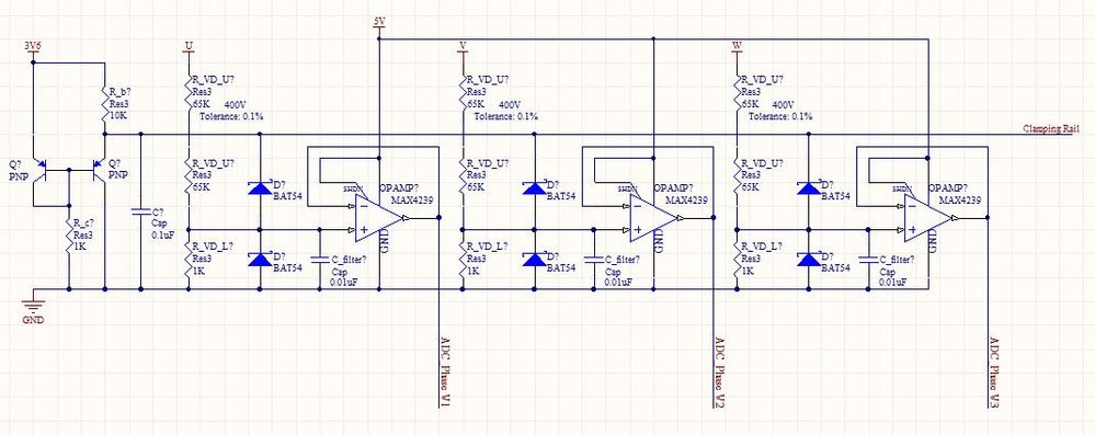

Is this going to be too hard to get them sampled within a reasonable time? Another alternative is to just use the DC bus voltage and switch states to estimate the 3-phase voltages. Although this is mathematically less accurate, perhaps just having 3 ADC conversions (DC bus voltage, and 2 currents) will end up a more accurate solution?
Also, my UVW phase voltages will be 0~400V . I was thinking of scaling the voltages 130:1 (max 468V) and clamping using the following schematic. Thoughts? Im not sure what value i should use for R_o.

BTW - Here is my updated schematic. I have added the buffer opamps and moved the clamp to the input of the opamp rather than Vout.
I am running the opamp at 5V now to stop it going into overload if signal ever peaks above 3.6V (has a 3.3ms overload recovery time).
Also because the input is a square waveform, I've added in a filter cap C_filter to filter out some noise on the otherwise DC (once settled) signal.
Having some difficulties sizing it though, because I'm confused of its time constant due to the resistor in parallel. I want it as large as possible with maintaining a 5*RC < 2.25uS (slew time of the opamp)
