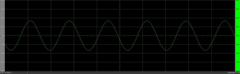

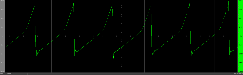

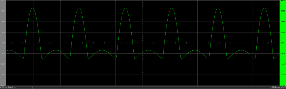

First, when I am using the full range of the DAC with values from 0 to 4095 the signal gets distorted like this for sine and ramp:
whereas using the range from 0 to 2047, the signal looks great like this:

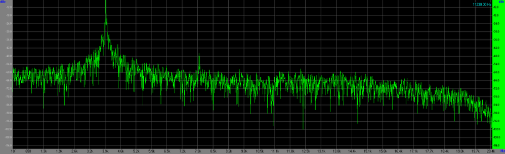

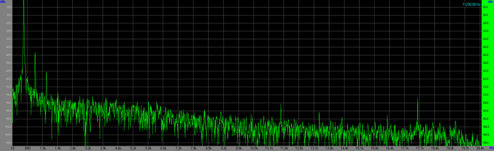

Second, using the smaller range, when I am going to higher audio frequencies the SNR suffers greatly as seen in these spectra:
with frequencies over about 5k or 6k being reduced to white noise.

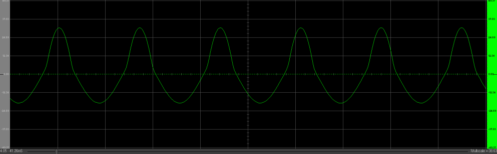

Third, using the buffer distorts the signal even worse like this:

You did not tell us which STM32 are you using, but generally the STM32 DAC does not cover the whole range well, and with buffer it's even worse. Review the DAC parameters in datasheet.
