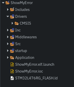

Every project generated in CubeMX with Truestudio as the target fails.
The project generates ''Virtual'' folders in Drivers but the contents of the folders are missing. Compilation fails due to missing HAL_ driver source.
Also generates a ''Virtual'' folder called Application but that folder does not exist. What is the purpose of it?

Ah. Fix is to uncheck ''Generate in root'' in project config;

This has been resolved in CubeMx 4.25. Thanks ST.
