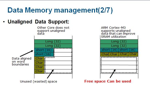

Dear All,
As we can see in the attached picture the ARM support Unaligned and Aligned data support
Please advice what mechanism is using by arm to identify two or three or four operand at single memory address

Posted on November 25, 2014 at 19:09
This slide is garbage. What dumb processor is not able to read a byte from a location that is not word aligned ?
The teacher mixes unaligned read (read a word from not word-aligned location) and variables allocation.

Posted on November 25, 2014 at 22:21
This slide doesn't capture the essence of what is meant by unaligned data support in the CM3 (or at least STM32)!
The long word (32 bits) can be placed at (addr % 4) or ((addr % 4) + 1) or ((addr % 4) + 2) etc. The only time that long words and words are
required
to be aligned to their respective boundaries is when using the DMA functions and also when using the load /store multiple registers (possibly also push and pop instructions). The only downside of having unaligned data is that it requires multiple memory accesses to read / write the data, but for the most part the overhead is scarcely noticeable.
The support for unaligned data was actually the cause of a bug in an older version of the GCC C++ library function for implicit memcpy, as it was using the load / store multiple registers to ''optimise'' the memcpy - which didn't work at all well when the items being copied where not aligned.
