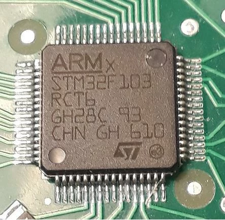

hello dear forum,
I used to buy STM32 F103 mcus from my countries biggest supplier
this IC below is 5,- USD there

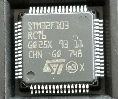

now becouse of competition I need more cheap products and I imported
this below IC for 2,35 USD from China
I soldered this on to my board and I saw that it is working
( I downloaded code and tried some peripherals )
I could not check all the functions yet
my question ;
this big price difference makes me suspicious
is this second picture genuine or clone ?
did you experience this second ICs ?
can I trust this second ICs ?
whats your opinion ?
thank you

hello
thank you for the comments
The ICs I imported were unused and they were never soldered  before
but I still didnot get any answer to my original question
are these ICs a ST product or not ?
thank you

It's hard to tell if they are counterfeits by only looking at the package marking.
The year codes, 610 (2016/week10) and 748(2017/week48) are different. This might even mean they're made or packaged somewhere else on different machines.
You're more likely to encounter discarded chips (eg: out of spec) that some untrustworthy fab still sold by the backdoor. This happens sometimes. Rarely they even get shipped to top tier customers or distributors, that's when the quality department gets very nervous.

A distinction is made between real and fake st products - it is possible when bathing microcircuits in acid. With a dissolving plastic - on a counterfeit chip, an additional crystal will be visible flash memory - soldered directly to the main processor, almost like a sandwich. This chip contains one flint plate.

‌ we cannot confirmjust looking at picture #2 that this is a genuine ST part.
We recommandto buy ST products
only fromofficial ST resellers

It's hard to know if a chip is original,. The only way is is you send it to the manufacture for analysis.
My experience with 2nd imitation though it seems to function well at the beginning, There are issues of reliability.
It might fail after short time and also quality may vary between batches or even in the same batch.

It looks like some counterfight chip. Try to see if Your programmer Tool can read the type and serial from a 'good' chip and from these cheap ones, I guess, You cannot read from the last one.

I have a hard time believing THIS chip to be counterfeit.
From a cost-benefit point of view, this sounds ridiculous.

Dear Sir;
You may submit an online support ticket, and we can try and help you. We will need photos of the label on the reel, if any, or other shipping labels. Also, please let us know who the vendors are when submitting the support ticket.
