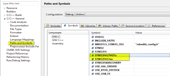

By "no changes" do you mean the same Cube project will "just work" (maybe with a new debugger setup to accept the different CPU - I have never done that since somebody else set up Cube for me ~ 3 years ago) or do you mean one has to create a new project with ST HAL libs changed from 32F407/417 to 32F427/437? The latter is probably not a small change.

For the library (CubeF4), if you don't intend to use any of the extra peripherals, you can still pretend that you are using 'F417, just change the linker script to cater for the bigger memories.
The clicking configurator (CubeMX) should work as with 'F417, too, again if you don't want to use any of the extra features.
However, the debugger in IDE (CubeIDE) may be picky about the chip's ID. I don't know if it is and I don't know if anything simple can be done about it - I don't use the Cubes.

I think there is no problem with the debugger or the loader. They read the chip ID to get the proper .stldr file.
I already move a project from G431 to G491 (and reciprocally) by changing the MCU name in the compiler symbols and the linker script (not a MX project!).

The MX "code generator" is not being used (it was used early on to get various code snippets).
Interesting about the debugger self-configuring the CPU P/N.
Yes indeed the CPU name is in the makefile generated script; no idea how it gets there.
The linker script I am familiar with.
Right click on the project name > Properties >C/C++ Build > Settings > MCU Compiler > Preprocessor
There is a define like "STM32F446xx". It allows to include the proper MCU file.
Also in C++ Proprocessor.
PHolt.1
Senior III
Thanks - also apparently here
