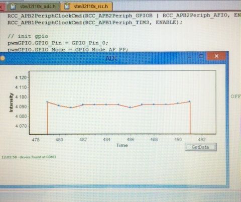

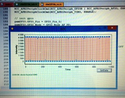

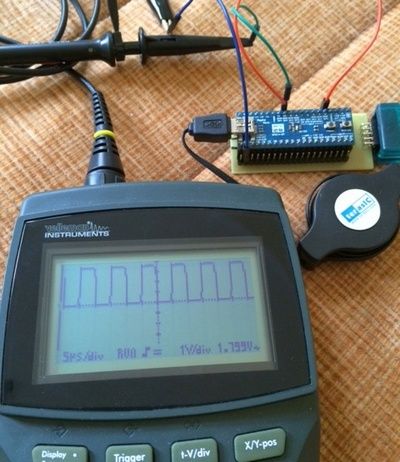

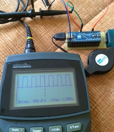

kudryashovda
March 12, 2016

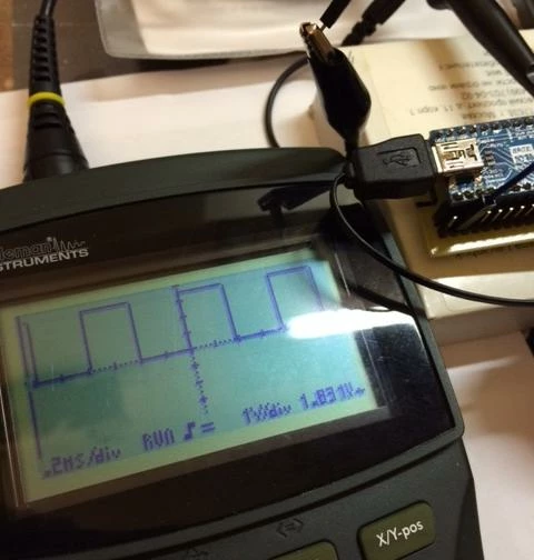

Posted on March 12, 2016 at 10:34
Uploaded some photos to my previous post.
A little comments. I started TIM3 timer inside code to generate square pulses with 5 us width:
pwm.TIM_Prescaler = 36 - 1;
pwm.TIM_Period = 19;
pwmOC.TIM_Pulse = 10;
and connected TIM output via wire to adc input. My home DSO shows 5 us pulses and in my Delphi programm I see 13 points per pulse = 5 / 13 = 0.38 us resolution 0690X000006034VQAQ.jpg 0690X0000060382QAA.jpg 0690X0000060387QAA.jpg
Tesla DeLorean
Guru
March 12, 2016
Posted on March 12, 2016 at 13:24
I'm pretty sure it is not operating at 0.39 us, looking at the configuration the 18 MHz ADC clock should deliver 0.777 us. The 1us (1MHz) would come if clocking at 14 MHz, the supposed max rate of the F1 ADC.
To measure sample rate, I'd generally prefer to do 1000 samples with circular DMA, and toggle a GPIO in the DMA TC, and scope that.

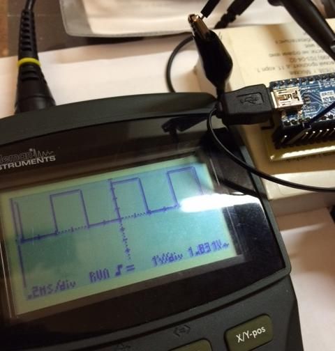

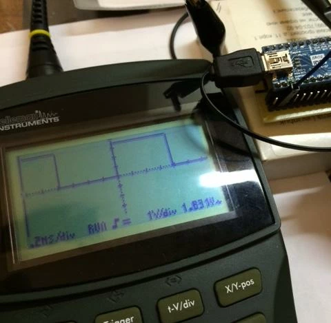

kudryashovda
March 12, 2016
Posted on March 12, 2016 at 18:39
Thanks clive to reply!
Here is my test with toggle pin after cyclic DMA transfer of 1000 bytes fron ADC 0690X00000602rvQAA.jpg The time of one transfer if about 400 us so 1 sampling is 400 us / 1000 = 0.4 us. The code is here:

One interesting thing I found - if to comment these calls:
Set_System();
Set_USBClock();
USB_Interrupts_Config();
USB_Init();
then the results is: 0690X0000060388QAA.jpg 800 us / 1000 samples = 0.8 us that is close to 1Msps. So USB settings change something to increase ADC? Or maybe here is something that I missed?
