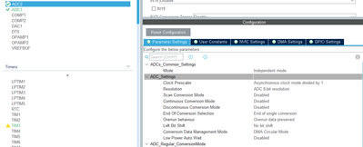

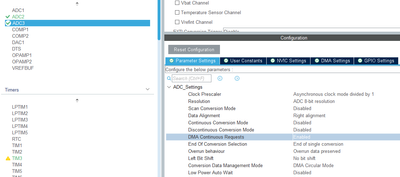

Hi All,
I want to use two ADCs on STM32H7 configured equal, but using one DMA each, and measuring on different channels. However it seems like the ADC3 have options ADC1 and 2 doesn't have. In this case DMA continuous request.
Is this intentional? A workaround?
Best regards!
Sarra.S
Hello @elso,
Indeed, please refer to RM0468 where there are two paragraphs one for ADC1/ADC2 and the other for ADC3
