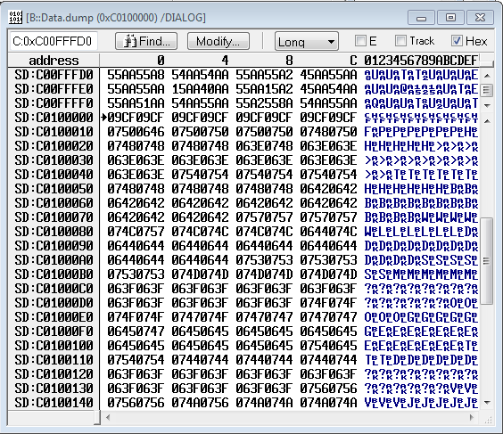

I am using stm32f427 chip with external SDRAM. I tried to implement ADC triple mode but I found the raw data transferred to external memory by DMA is duplicated or corrupted.

Here is the dump. From C01000000, we can see the duplicated data.
What confused me is that I did ADC_Mode_Independent ADC_DMAAccessMode_Disabled only to transfer ADC1 data and the data is totally correct. From my point of view, it should be some part related to ADC common where I set it wrong. Can somebody help me find out this?

    Try one of the example of this that I've posted and confirm if that does, or does not, function correctly with a SDRAM destination. I don't really have the time/patience to keep fixing everyone's broken code. Start with something that works, then push that till it breaks.

    ok The problem is fixed. It needs to put the code below.
    ADC_MultiModeDMARequestAfterLastTransferCmd(ENABLE);
