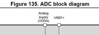

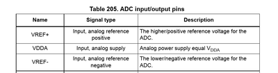

You didnt tell, you are using separate AVREF , so ... i would say:
So what you see, should happen on the pin : check with scope, whats really on the pin.
+ on Vref ... (adds directly to the ADC result)
TL431 is a shunt regulator - not suited here as low impedance reference.
Better use NO adc reference , just connect avref+avdd to vdd , but use a good 3,3V regulator (1% tolerance or so), this is better than fiddling around with not suited parts.
If you really need better , use a precision reference, like REF3030 . https://www.ti.com/product/de-de/REF3030
You cannot use internal 1,1V , see rm:
you can only read it , for reference (as its name suggesting).
vref is on a real world pin :

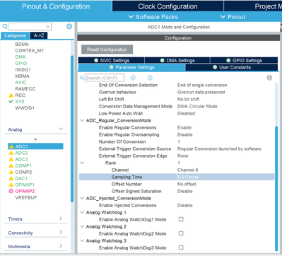

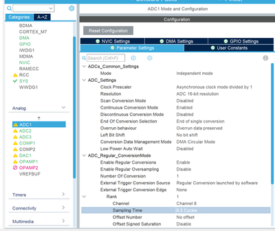

I need to add that i tried to change alot of settings of ADC in Cube MX but nothink helped, my  current setup is

>My question is how can I setup ADC to let it recharge capacitor afrer every conversion in DMA mode?
No , the sampling cap is connected to pin on the (8.5 ticks here) sampling time - on every conversion.
Connect 100nF cer.cap from ADC in (this pin) to gnd. (short wires !) Then check again, what comes out.
You set "continuous" conversion request - you want this really ?

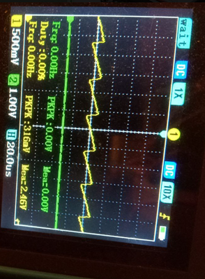

my osciloscope don't see any pulsations.
Those pulsations fully repetetive i reviewed my PCB and found nothink which can have such frequency.
I'm debuging my STM throw STlink, but I don't think it can't generate pulsations on supply line because i have near 200uf of ceramic caps near my MCU
SFediakovAuthor
May 5, 2024
Ok, I found issue- it was my external V ref which I made using TL431. Have no idea why it pulsating, probably pullup resistor have to big value.
