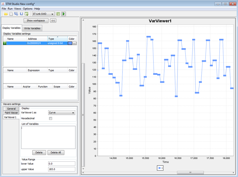

I have many problems to have my ADC work.
Please, have a look on my code :

I test DMA_GetITStatus(DMA2_Stream0,DMA_IT_HTIF0)==RESET and ADC_GetFlagStatus and DMA_GetFlagStatus but none works. Either I have an infinite loop, either I have my LED blinking but if I change the prescaler for example, sample time don't change...
More over, I discover that ADC 1 and ADC 2 doesn't take the same duration to convert...
I am a bit confused with this ADC configuration. I need some advices on this.
Thks.
Tesla DeLorean
Guru
July 23, 2013
Posted on July 23, 2013 at 16:47
There seem to be some inconsistencies in the channel selections, I don't think you want to be scan converting with a single channel per ADC (scan implies you have more than one). I personally prefer to pace ADC conversions with a timer rather than jam them back-to-back. This way the sample rate in unambiguous. Check also the rated speed of the ADC, the CPU should perhaps be running at 144 MHz, not 168 MHz
I suspect the HT (half-transfer) of a 2 16-bit word buffer churns at an excessive rate. I would make the buffer bigger, for HT to make any sense you'd want at least 4 16-bit words to how two pairs of samples. This is how I'd attack a dual channel acquisition.

Obviously, I am confronted to a new problem : I test the output ADC's values. I send to PC2 an signal between 0 and 1 volt -don't consider impedance issue, and it is not a sampling frequency issue- I check the voltage value on PC2 with a voltmeter.
I look converted values with STMStudio for example, but I obtain funky values (It seems to be random values)...
Let's have a look of this :
I don't understand why whereas my circuit seems well done, and I don't forget to link the GND pin...  The only
What can be the cause of such a problem with the ADC's converted values ?
Thks.

I don't know how you are generating the 8-bit value you are watching. If you are getting a lot of variability you could increase the ADC's sample time cycles.
paul-henri
July 30, 2013
Posted on July 30, 2013 at 17:44
I make a cast...
i = (uint8_t) convertedValue;
Changing the sample time doesn't change anything...
