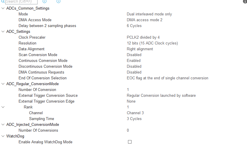

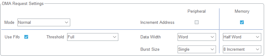

Hello, i am using STM32F746ZG to sample and process large amounts of ADC data. To increase it's speed dual interleaved mode is used. And because of low processing speed, the main idea is sample many samples of single channel (~50K) and process them.
First time, I call ADC, all works as expected and i get interrupt when buffer becomes filled.
 HAL_ADC_Start(&hadc2);
 HAL_ADCEx_MultiModeStart_DMA(&hadc1, (uint32_t *)AData, sizeof(AData) / sizeof(uint32_t));
void HAL_ADC_ConvCpltCallback(ADC_HandleTypeDef* hadc) {
 HAL_ADC_Stop(&hadc1);
 HAL_ADC_Stop(&hadc2);
/* send signal that data is ready */
But when it is called next time, no interrupt is generated. I can see that ADC is enabled and running, but DMA doesn't transfer any data (DMA NDTR doesn't decrement over time). So after some search i found this in reference manual for MCU:
Bit 13 DDS: DMA disable selection (for multi-ADC mode) This bit is set and cleared by software. 0: No new DMA request is issued after the last transfer (as configured in the DMA controller). DMA bits are not cleared by hardware, however they must have been cleared and set to the wanted mode by software before new DMA requests can be generated.
But reset of only this register did nothing. At the end only this way worked for me:
 ADC->CCR &= ~(ADC_CCR_MULTI);
 ADC->CCR &= ~(ADC_CCR_DMA);
 ADC->CCR |= ADC_DMAACCESSMODE_2;
 ADC->CCR |= ADC_DUALMODE_INTERL;
I am trying to understand what this lines do, because they don't change anything, because the same configuration was written to CCR in MX_ADC1_Init function. Is this the only way to make this setup work?
Thank you and sorry for my poor language skills.

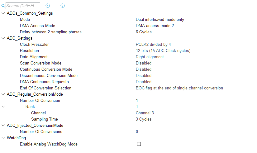

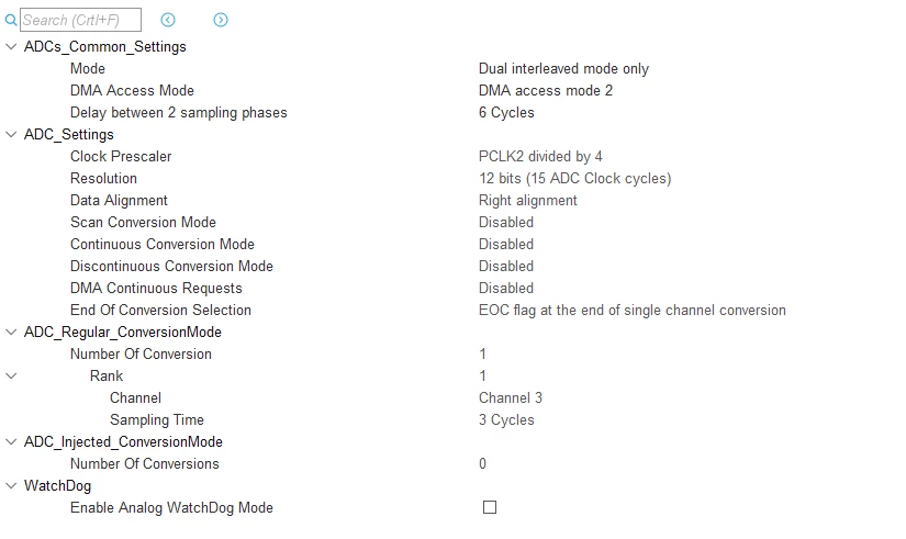

Here is my configuration, ADC1:
ADC2:
